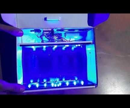

Step 1: Making Cutouts on Front Panel of the Box and Placing the Foam Sheet and Diffuser Sheet on the Back Side
I'll start off by placing the GLCD on the top of the front panel.
I usually cut plastic by heating an old knife and sliding it slowly on the markings I made.
After GLCD, I'll make the cutout for the ultrasonic sensor.
OPTIONAL THING :
If you're using a box-like me and have a vinyl sheet or any type of sticker sheet(Black colored) so you can also use a foam sheet/cardboard sheet along with a diffuser sheet to make it look even more elegant.
I first cut the foam sheet to the size so that it can fit inside the lid of the box(The front panel of the end machine)
Then I made the cutout matching the pattern on the lid.
I also cut the diffuser sheet with the same size as the foam sheet and stuck them together.
Step 2: (OPTIONAL STEP)Sticking the Vinyl Sheet and Cutting It Along the Box Cutouts and Placing/fixing the Components
After cutting the foam sheet and diffuser sheet, I stuck the black printed vinyl sheet on the box lid and let it sit for an hour or so.
After which I made the cuts along with the box pattern(bevel shaped) which makes it look like the pattern is intentionally made for light to come out which looks pretty cool!
Step 3: (OPTIONAL STEP)Fixing RGB Led Lights Along With the Relay Module
I carefully stuck the LED strip so that it lied just below the cutout made on the lid. So that when the light glows it is throwing most of the light on the diffuser sheet and it glows bright.
This is really an optional step only if you want a soft led touch around the machine.
I used a bit of flex glue so that the LED strip is really rocked tight to the box.
Now I had the 4 channel relay module and the LED strip requires only 3 channels so I used the 4th channel for controlling the pump. The pump won't be supplied by the 12 volt supply but rather would be supplied directly by the 5 volt USB jack via the relay so that if LEDs are not wanted to be ON the pump would still work.
And moreover, the pump I used worked well at 5 volts.

Step 9: CIRCUIT SCHEMATIC
You can refer to the above image to make the connections, but there are few changes in actual implementation as the schematic I drew was about a month ago, now this project has got a lot of changes, but you need not worry as I will specify each and every connection to be made.
Start off with GLCD connections to the Arduino mega.
The image is attached above.
Next thing is to connect the SD card module to the Arduino mega. The image is again attached.
The relay module used here is -ve logic one so get a similar one or you'll have to modify the code a bit.
So the relay module +5volt and ground will be connected to the 5volt DC jack as Arduino won't be able to supply enough current.
The 4 signal pins of the relay module named IN1,2,3,4 will be connected to Arduino analog pins A0, A1, A2, A3
3 of the channels would be used by led's and 4th channel for Pump control
You can use any pins but I tested and tried these pins and they work well.
Ultrasonic sensor :
ECHO: D39
Trigger: D38
SPEAKER amplifier:
Signal input of amplifier goes to D5 of Arduino mega(I do not recommend changing this pin not even in the code)
It has got something to do with the timers inside the microcontroller which are connected to few special pins only. Also, the PCM library used recommends using pin no D5 on the mega board.
These were all the connections to be made to the Arduino mega.
POWER CONNECTIONS:
I'll be using the boost converter to supply the Arduino mega via the 5 volt USB jack rather than directly powering it. This is because when I tried powering it using the 5-volt adapter directly via the Vin pin it was resetting sometimes which showed a lack of enough voltage to keep the peripherals ON and keeping the uC ON at the same time. so I Boosted the voltage at around 6.3 volts and then fed it to the Vin pin of Arduino mega and everything worked fine then.
The boost converter also features few capacitors which provide a smooth supply to the uC board ie the Arduino mega board.
