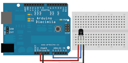

Step 2: Connecting Your Temp Sensor
Start by connecting your 5v and ground. Follow the picture on the bottom left. It will allow you connect all of the other components that also need 5v. Now connect your temperature sensor. Here is the basic pinout that you will need. Far left pin to 5v, middle pin to analog 0 on the Arduino and far right to ground. Also if you are new to using a bread board, here is a link to a breadboard tutorial: https://learn.sparkfun.com/tutorials/how-to-use-a-breadboard

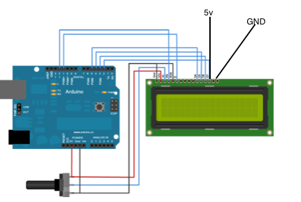

Step 3: Connecting Your LCD
Connect your LCD display and potentiometer. Follow this schematic exactly. The extra 5v and ground connections are only necessary if you want your lcd to have a backlight.
