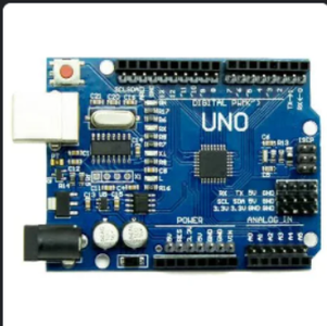

  1. Arduino® Uno

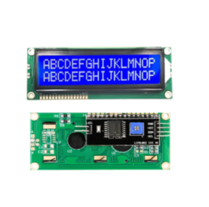

  3. 16×2 Liquid Crystal Display (LCD) with I2C Interface

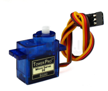

  4. Servo Motor

  1. Arduino Uno as the brains of the system which can get the sensor data , display details in the LCD control the servo motor and all.

  3. 16x2 LCD display: Act as a mode of communication with the driver or the user in the toll gate
  4. Servo Motor:

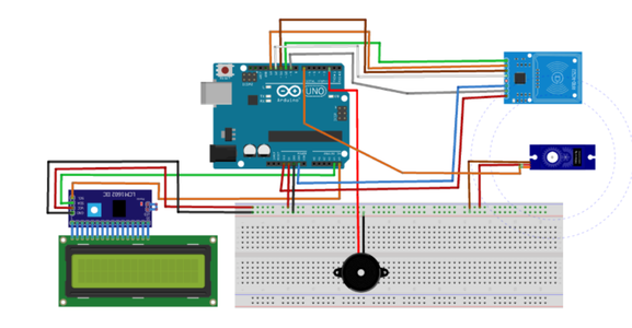

Step 1: SETTING UP THE HARDWARE CONNECTIONS
Please make sure that you power the system using the barrel jack with power source between 7v and 12v, use USB for only data transfer.
Connecting the RFID sensor
  1. VCC -> 3.3v ( only power from 3.3 else it will burn )
  2. GND -> GND
  3. RST -> D9
  4. MISO -> D12
  5. MOSI -> D11
  6. SCK -> D13
  7. SDA -> D10
Connecting the LCD screen
  1. VCC -> 5v
  2. GND -> GND
  3. SDA -> A4
  4. SCL -> A5
Connecting the Servo Motor
  1. VCC -> 5v
  2. GND -> GND
  3. SIGNAL -> D6
