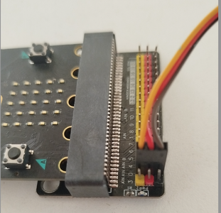

Step 3: Connections
Orange servo cable → Micro:bit pin 0
Red servo cable → 3V
Brown servo cable → GND
