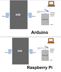

Step 7: Top Platform
Now you need to attach the last part of the can- you will need a camera, some sticks (popsicle will work), 2 servos, and a platform. The platform must be the same color as the one you took your pictures on.
  • Attach the 2 servos on either side of a small platform
  • Adjust your camera angle to where the camera captures the entire platform
Next you will build a stand for the camera. It will look like an upside-down 'L'. The longer side must be the same distance as your camera was away from your objects while taking the pictures. The camera must face down towards the platform. Have your other side reach out to the middle of the platform. Then check to see if the camera's angle catches the whole platform, and that the model works. If you are using Arduino, connect it to the computer, if you are using Rasbery Pi, connect to the board.
Then attach the platform and servos to the opening of the trash can.
