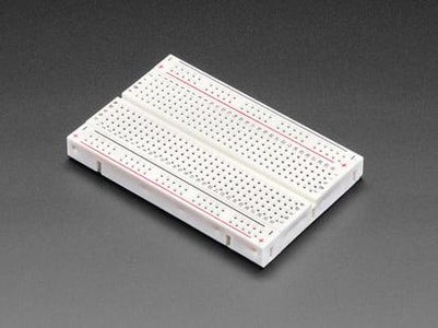

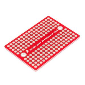

  13. Breadboard (optional): You can find it on adfruit. There are two kinds of bread board. One is for beginners, the other one you have to solder it. I use the beginner one to test my circuit design, and use the solder one for my final design.

I tested my circuit using a breadboard that was not soldered. I first assembled the parts of the heat pad and connected the circuit board to my computer to test whether it ran successfully. Then I assembled the tiny fans part for testing. The purpose of doing this step by step is to separately check that my code, components, and circuit assembly are working.

Then, weld the breadboard.
