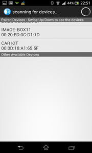

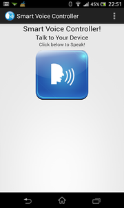

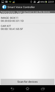

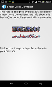

Step 1: Software for Smartphones With ANDROID:
The software converts your voice commands and sends them to the controller. For this conversion need to have Internet connectivity on your phone. Commands wich will controll each individual relay output (or multiple outputs), must be predefined and stored in the controller below. ie each relay should know what command will change it's state.
Example:
relay 1 (ON) - Voice COMMAND: light on
relay 1 (OFF) - Voice COMMAND: light off
relay 2 (ON) - Voice COMMAND: fan on
relay 2 (OFF) - Voice COMMAND: fan off
Command for relay response is pre-set in the Arduino controller software which we describe below in the article. To download the software for Android, visit section Software for Android in the Author's website.

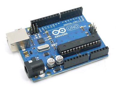

Step 2: Controller (with 8 Relay Outputs):
To make the controller there is no need to have skills in making circuit boards. The controller is constructed of 3 modules which are sold at electronics stores. You only need to connect them as described. Even if they are not available in local stores in your town, all devices can be ordered online.
Arduino UNO - Look at Ebay.com

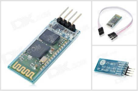

JY-MCU Bluetooth module - this is serial bluetooth module but placed on board to work with 5 volts. Can be used only HC-05 or HC-06 if you do not find JY-MCU but remember to lower the voltage to 3.3 volts. JY-MCU can buy from DX.com

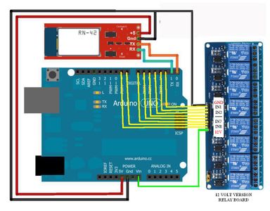

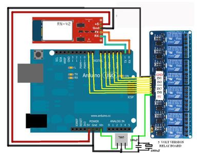

8 Channel 12V or 5V module for Arduino - it is recomпended to use a 12 volt model of the shield, although the 5 volt are most used. If triggered 8 realys with 5 volts supply taken from Arduino voltage regulator has risk to preheat the regultor. For this reason we use 12 volt version and take the power directly before build-in voltage regulator in Arduino. You can find shield in Ebay.com
12V power supply - can be purchased from any eletronics store.
Step 3: Controller Software (for Arduino):
The code of SVC_Arduino.ino is attached article in the authors website. Click below to view the source code .The code must be loaded into the Arduino to be able to respond to your voice commands. With red colored lines is marked the code where you can change it to use your custom voice commands. You can also add process like allon() in the code, to trigger only a couple of relays simultaneously with one command, instead of all (as is done with the voice command all on/off below in the code).The schematic can be set to react in different languages. Once you upload the code to the Arduino, the schematic does not require computer to work.
When programming the Arduino. disconnect TX and RX pin from the Bluetooth module because it can cause a conflict in communication and may not be able to upload the software.
