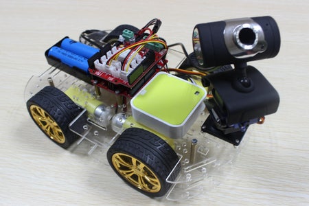

Step 1: WHAT SHOULD WE PREPARED
Module Preparing: OK! Let’s begin. You should prepare these before assembling, both of them are cheap and easy to buy.
1. Crowduino UNO X1 - A 100% Arduino compatible board
2. Crowtial- Motor base shieldX1 - A motor driver shield to control the motor and connect to other sensors
3. Crowtail- WIFI module X1 - Transfering the video stream and control commands
4. USB camera X1(Capture video). - Used to capture the video
5. 4WD Utility CarX1 - The best platform for mobile application.
6. Pan-Tilt X1 - Control the movement of the camera
7. Battery and battery holder.
Step 2: Assemble His "BODY"
1: LEGS(motor)
It has four ”legs”, you should welding wires on them to make sure it can run up. then you need to fasten them to chassis by using motor bracket as above pictures show.
2: BODY(acrylic chassis)
Install four copper cylinder brackets on the down- chassis for fasten up- chassis,and three copper cylinder brackets on the up-chassis for Crowduino. you can choose each piece of chassis as down-chassis and left one for up-chassis.
3:FEET(wheel)
At last. let’s install the wheels. A basic 4WD Mobile platform has been completed.
Step 3: Assemble His “BRAIN”
After assembling the car, we need to start the electronic parts---the brain. The first role is the Crowdunio UNO, fasten it on the three copper cylinder. the next one is Crowtial - Motor base shield. Plug it onto the Crowduino UNO. Then we should link the motor to the “brain”, there has something important enough to pay attention to it. Like human’s nerve, you also couldn’t make fault at this step. Or you will destroy the brain. Please observe the above sketch picture carefully.
Step 4: ASSEMBLE HIS POWER
We need two batteries and a battery holder.
Fix the holder on the up-chassis. and The red cable connect to the VIN of Crowtial- Motor base shield, the black cable connect to the GND of Crowtial- Motor base shield(DO NOT MIX UP). Unfortunately we make the mistake due to our careless. So we lost a Crowtial- Motor base shield. Forget this unhappy experience and let’s go on…
Now it's time to power it and make a test to insure that can run up rather than going round. It’s ashamed if we make a “smart car” into “stupid car”. Connect the Crowduino UNO with USB cable to PC and Upload the test code into it. if you see that the wheel can’t run in the same direction after powering your car , please exchange the two wire of the motor. For example: if the Motor 1 go forward, but the Motor 2 go back, Now we just change the cable of motor 2, the red cable to OUT2,the black cable to OUT1, then test again.
Step 5: ASSEMBLE HIS "EYE"
Now search an eye for him is emergency. This eye require to be turn to multi-directions. So we combine the pan-tilt with the webcam.Genious! Let's work!
1:Install the Pan-Tilt.
The Pan-Tilt have four holes in the chassis, fix the Pan-Tilt on it with screw.
2: Plug the camera onto the Pan-Tilt.
3: Bind the WIFI module.
4.Connect the WIFI module to the UART port of Crowtial- Motor base shield.
5.Connect the Pan-Tilt to the Crowtial- Motor base shield, up-servo link to D7 and down-servo link to D6.
6.Connect the camera to the WIFI module with a USB cable.
Finally, we can clean up the cable, and make it looks more comfortable! Okay! A WIFI VIDEO REBOT CAR has been completed.
