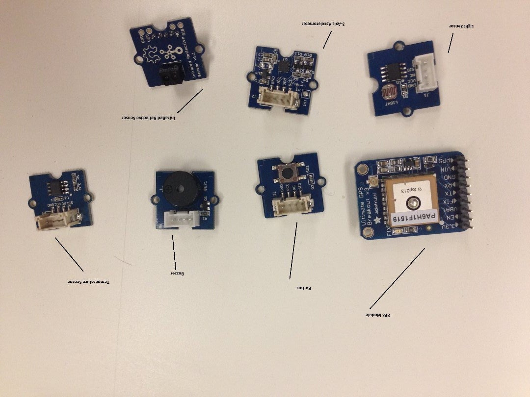

List of Materials
Hardware
1) Intel Edison
2) Arduino Breakout Board
3) Arduino I/O Shield
4) Adafruit Ultimate GPS module
5) Groove - Buzzer
6) Groove - Infrared reflective sensor
7) Groove - 3 axis digital accelerometer
8) Groove - Button
9) Groove - Light Sensor
10) IOS/Android SmartPhone

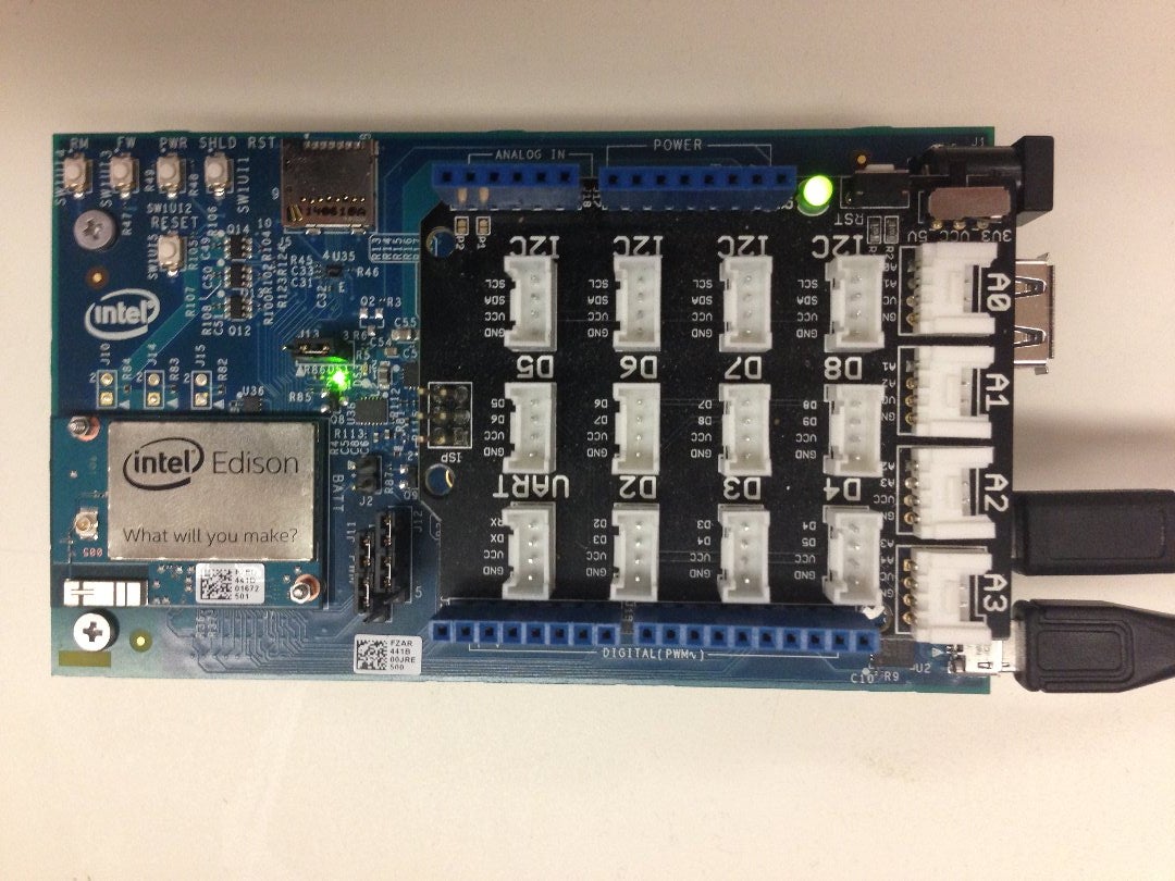

Hardware Setup.
1) Connect the I/O Shield over the Intel Edison.
2) I2C - Accelerometer
D2 - Switch
