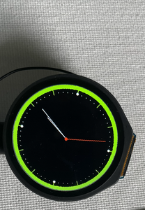

We have designed smartwatch using an ESP8266 microcontroller, a GC9A01 round display, and a custom-designed PCB. The steps cover everything from PCB design, component soldering, uploading firmware, and 3D printing the case to assembly and finalizing the smartwatch.

Step 5: Assembly
  1. Power On the Watch:
  2. Test the smartwatch by powering it on. Ensure the display works, the firmware runs correctly, and all buttons and sensors respond as expected.
