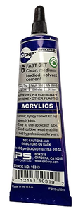

Step 1: Assemble the Acrylic Frame
  1. Laser cut an acrylic sheet using the illustrator file below.
  2. Use acrylic cement to attach the 4 acrylic pieces to create the structure shown in (Figure 02 and 03). Acrylic cement is crucial as it is able to chemically bond the acrylic pieces together. Since the container will be filled with water, it's important that the acrylic is securely attached to prevent any leaks.
  3. Allow the frame to dry for about 24 hours for 100% strength.

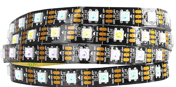

Step 5: Surround With LEDs
To install the individually addressable LED strip, follow these steps:
  1. Cut the LED strip to the necessary length to wrap around the container using a sharp cutting tool.
  2. Stick the LED strip onto the side of the acrylic frame. You can use hot cement to attach the strip to the frame.
Once you have securely mounted the LED strip, connect it to a power source and test the lights.

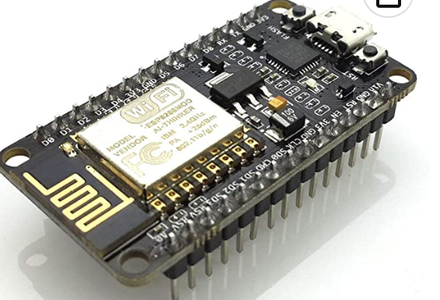

Step 6: Connect the ESP8266 Module + WLED Setup
To set up your LED strip with WiFi connectivity, follow these steps:
  1. Begin by acquiring an ESP8266 module that emits WiFi signals and connect it to a computer using a microusb data cable.
  2. make sure that your microusb cable can transmit data
  3. Download the "1.2.0 - ESP32 Home Flasher" application from Github
  4. Open the application and click on "Flash ESP"
  5. After flashing is complete, a new Wifi connection will be available and you should connect to "WLED-AP"
  6. default password = wled1234
  7. Once connected, click on WiFi settings if you want to do some customization.
  8. After you are done, a screen shown on Figure 7 should be available for you to play around with the light settings
  9. Use a suitable cement type to fix the ESP module onto the bottom of the acrylic frame, as shown in Figure 08.
  10. Connect all the wires from the LEDs to the ESP8266 module to establish connectivity:
  11. Data, green wire connects to D4
  12. Positive, red wire connects to 3v3
  13. Negative, white wire connects to GND
  14. (The last image has the circuit diagram for reference)
By completing these steps, your LED strip should now be ready to receive WiFi signals and can be controlled via your smartphone or other connected devices.

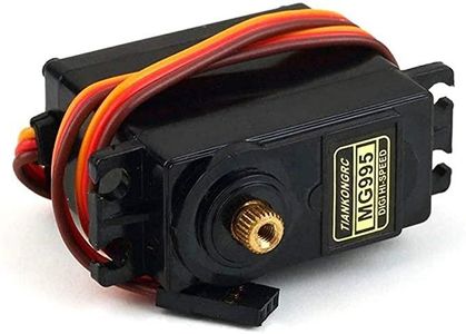

Step 7: Attach Servo Motor
  1. Begin by attaching the aluminum adjustable servo horn to the MG995 servo motor
  2. Fix the servo motor to the acrylic frame using hot glue, as shown in Figure 02 and 03 (glue it to the side with the string coming down).
  3. Move the servo horn so it is pointing straight up
  4. Then, tie the string to the top hole of the servo horn and hot glue it

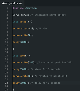

Step 8: Connect Microcontroller to Servo
To set up any microcontroller to control the servo (I used another ESP82666), follow these steps:
  1. Begin by downloading the Arduino IDE
  2. Acquire any microcontroller and upload the code provided above to the board.
  3. Make the circuit using the instructions shown in Figure 02 and 03.
  4. If you are using another Node MCU ESP82666 for the servo connect the wires as such:
  5. Data, orange wire connects to D4
  6. Positive, red wire connects to 3v3
  7. Negative, brown wire connects to GND
  8. (The last image has the circuit diagram for reference)
  9. Next, use hot glue to fix the microcontroller onto the acrylic frame.
