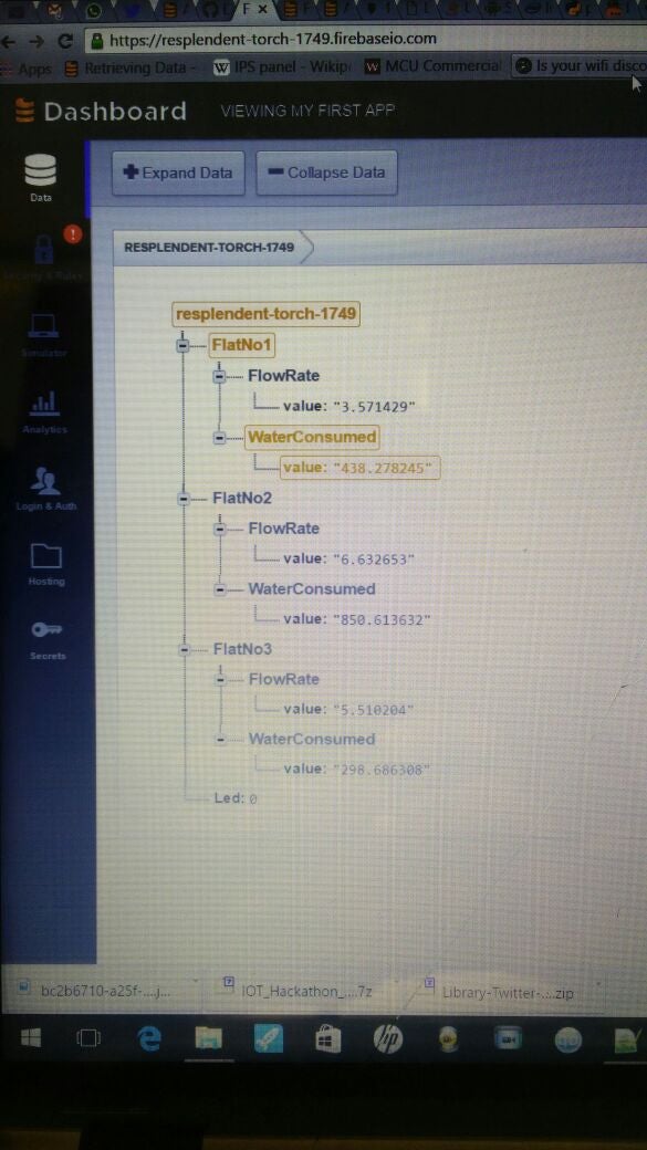

7. Create an account and you will be able to set up, for free, a new storage with the address FBNAME.firebaseio.com, where you choose what FBNAME is. Here I created an account and the FBNAME is "resplendent-torch-1749"
8. Let's try to push the data to firebase.
firebase.py // sample program
from firebase import firebase
app = firebase.FirebaseApplication('https://resplendent-torch-1749.firebaseio.co app.put('/', 'humidity', {'value': 10.0})
9. Save the file and run the script - This will create a variable named "humidity" with value "10"

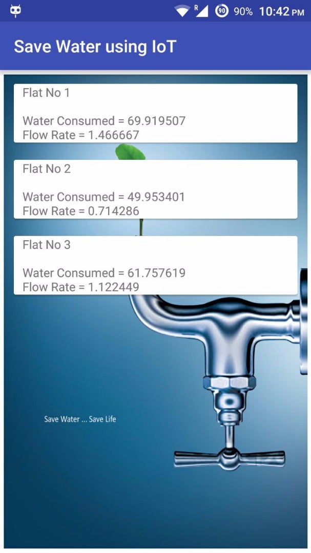

Step 3: Firebase to Android App
FireBase to Android app setup is very well explained at FireBase site
https://www.firebase.com/docs/android/quickstart.html

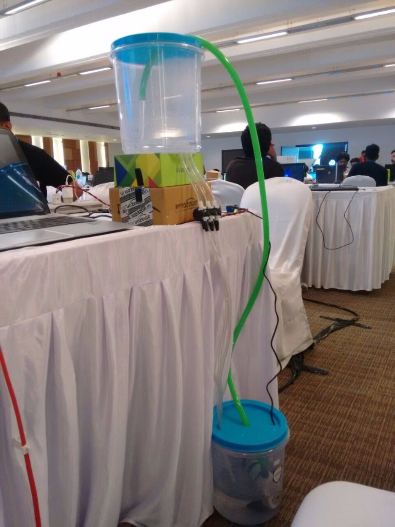

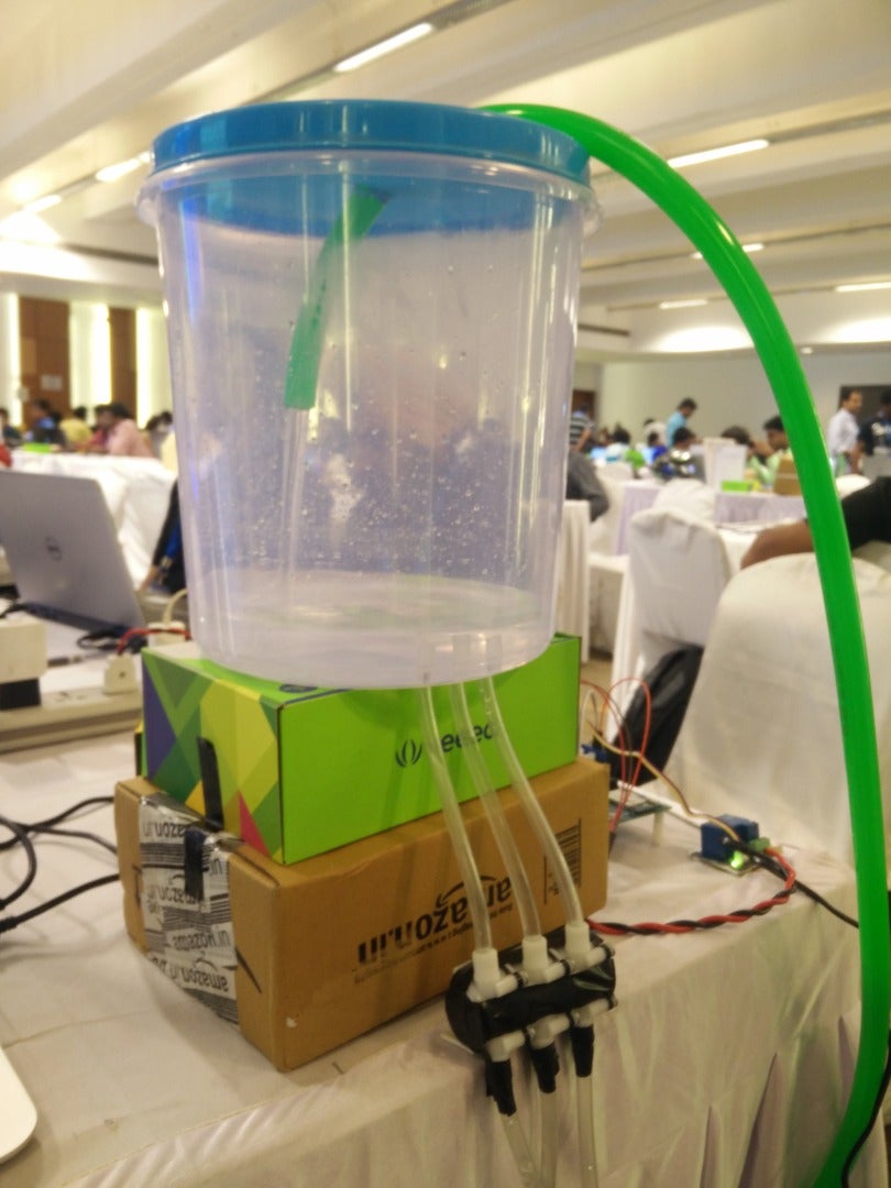

We have connected 3 flow sensors which read the water consumption and flow rate data to the FireBase cloud.
A relay is used to control the water pump ON/OFF. If the water flow in 3 sensors read 0, then relay turns On the water pump to pump the water to the upper tank. Also this relay switch handle is provided in Android App to control the water pump remotely.
