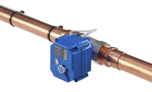

  6. Optional: see the 3rd picture in this section, install the remote water shut-off valve for your water softener. These valves are available at stores like Home Depot or Menards, typically priced around $125. It allows the iQua app to remotely shut the water off or write a Python code for automatic shut-off.
  7. Home Depot: https://www.homedepot.com/p/Rheem-Preferred-Series-Remote-Water-Shut-Off-Valve-7388598/316362390#overlay
  8. Menards: https://www.menards.com/main/plumbing/water-filtration-softeners/water-softeners-cleaners/morton-reg-motorized-water-shut-off-valve/7379785/p-1562653716876-c-8682.htm?exp=false
