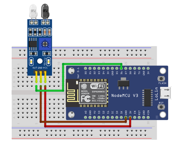

Step 2: IR Sensor Wiring
Connect the IR Sensor as the following:
ESP8266 >> IR Sensor
GND >> GND
3V >> VCC
D6 >> OUT

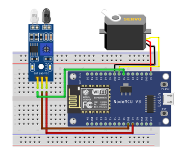

Step 3: Servo Motor Wiring
Connect the Servo Motor as the following:
ESP8266 >> Servo Motor
GND >> GND
3V >> VCC
D5 >> Signal

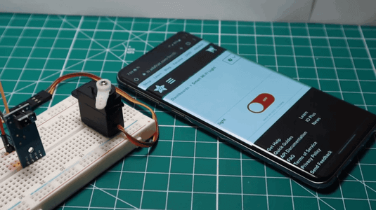

Step 12: Testing Online Server
If everything is working properly you should be able to turn the switch on and off on your phone and the servo should rotate up and down.
