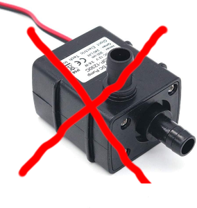

The first pump I tried was a simple and cheap AD20P-1230C 12 volts brushless DC pump (see image at left). But this pump was not capable of sucking the water from below. So I learned that I needed a so-called 'self-priming' diaphragm pump to do so. That's when I ordered this YX DC12V (see image at right).
