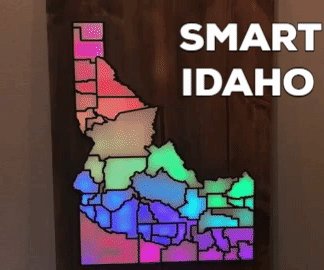

Introduction: Smart World Map With Data Screens and DMX Programmable Lighting
Our non-profit serves in many parts of the world but like any non-profits, the needs far outstrip the resources. We became interested in a way to create awareness of global need in different parts of the world as well as inform about work we were doing in various countries. We wanted an educational tool to inspire, inform, awe and motivate. The resulting idea was birthed!
The smart map is about 14 feet long and CNC cut from 1/2" MDF, illuminated by a series of inexpensive DMX stage lights, and controlled by three inexpensive PCs. Those three computers control three distinct functionalities of the map:
- The upper LCD screen is controlled by one PC and displays the heading video
- The lower LCD screen is controlled by the lower PC and displays the content video of equal length
- The third PC controls the QLight + DMX lighting software.
All three computers are then synchronized through three arduino nanos which communicate with one another over i2c bus to create seamless, beautiful, perfectly timed transitions. About one hundred videos are played in random, non-repeatable order. Once the videos are displayed the videos are shuffled and then start again. The content of the Smart Map is pulled from a simple Dropbox folder. Drop a video in the specified folder and it will be automatically added into the mix on the next cycle! It's a simple, elegant way to keep the content fresh and engaging.
The map is controlled via a smart phone, runs on a schedule and has received great feedback. We are thrilled with the result and happy to share the idea with the Instructibles community. The secondary benefit for me personally is that I document what I did in the most certain case that six months down the road I'll forget how the thing works!
