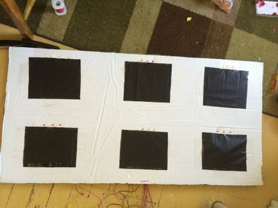

Step 4: Assembly of the Velostat
1. Once you have the basic alarm working, you can continue onto creating the mat. We simply used a 2 inch thick piece of foam mat.
2.From there, we decided that we wanted 6 different sensors in order to maximize the amount of poses / sequences that we could do. We measured the foam mat to be 8' by 2' and cut our velostat into 9" by 5" squares.
3. We then took the conductive thread and taped it to the back of the velostat in a U-shape so that it was covering a large portion of the square. We taped the conductive thread onto the back of the velostat using the Electric Tape -- Set Aside
NOTE:(conductive tape or copper would work fine as well, just as long as it is conductive. Cut the velostat into the squares sizes you want.
4. Now, we cut the wire roll into 18 different pieces using the wire cutters. (12 of these will be used to connect the LED lights into the Arudino board, the other 6 will be used to connect the conductive thread).
5. Strip both ends of all of the wires so that it can be connected to the conductive thread / LED's and to the Arudino wires.
6. Now, take 6 of your stripped wires and solder one end to the conductive thread and the other end to the Arudino connecting wires.
NOTE: if you have never soldered or need further instructions, please have someone teach you proper techniques or look up further inscrutables before attempting alone.
7. Once the velostat is assembled, we used the Exacto Knife and the Measuring Tape to accurately cut hoes through the foam, right in the middle under each velostat square. This is to pull the thread from the velostat to the backside of the foam so that all of the wires are hidden.
8. Now connect each of the ground pins into the Arudino and each of the power pins into pin states as well.
NOTE: in the above picture, we tested on a normal FDM pressure sensor.

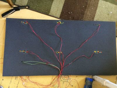

Step 5: Assembly of the LED Strips
Once the velostat is set up to the mat, it is time to set up the LED strips.
We used 3 LED lights per each square which created a total of 18 LED lights.
1. Take 3 LED lights and find the power and the ground ends (the longer end / pin is power (+)). Cut about 1" thick pieces of wire to connect each of the power ends to each other.
a. You will need to strip the ends of each piece of wire and than wrap / solder them to the LED.
2. Once you have connected each of the power ends to each other, do the same with the ground (-) ends. We also used the yellow tape to show which ends were ground and the red tape to represent the Power end, this way, we know where to plug in each of the pins to the Arduino.
3. Once the 3 LED lights have been connected, you can take the long 3' wire and connect one to the Power and one to the ground end of the LED lights.
4. After the long wires have been connected to the LED's, you can connect them to the Arudino connecting wires.
NOTE: be sure to properly label or remember which of your pins is power and which is the ground, otherwise, your LED's will not light up.
5. Use the measuring tape and the exacto-knife to cut 3 small holes centered above the velostat. Push the LED lights threw these small holes and leave the wires coming out the back / underneath the foam.
6. Now connect each of the power pins into a specific pin on the Arduino and each of the grounds into the ground state.
NOTE: we also used the electric tape to organize each of our LED strip wires. We put small pieces of tape connecting the power and the ground wires so that we knew where each wire was going to.

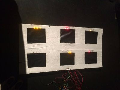

Step 7: Live Demo
At the end of the semester, we presented at the AtlasExpo at CU Boulder. Here is the video demo of our alarm:
