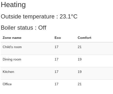

2. Heating
All heated zones are displayed on this page showing eco, comfort and current temperature, heating mode and heating status. It also shows outside temperature and boiler status if a switch node is connected to a boiler.
Heating settings can be edited for each zone. Heating mode can be 'Eco', 'Comfort', 'No frost' (temperature won't go below 5 degrees celsius) or 'Auto'. If heating mode is auto then the week schedule is used to set the temperature to eco or comfort value depending on the current day and time.
A script runs every minute and reads all the above settings. Depending on the result it will send messages to the nodes to turn on or off radiators and the boiler.
