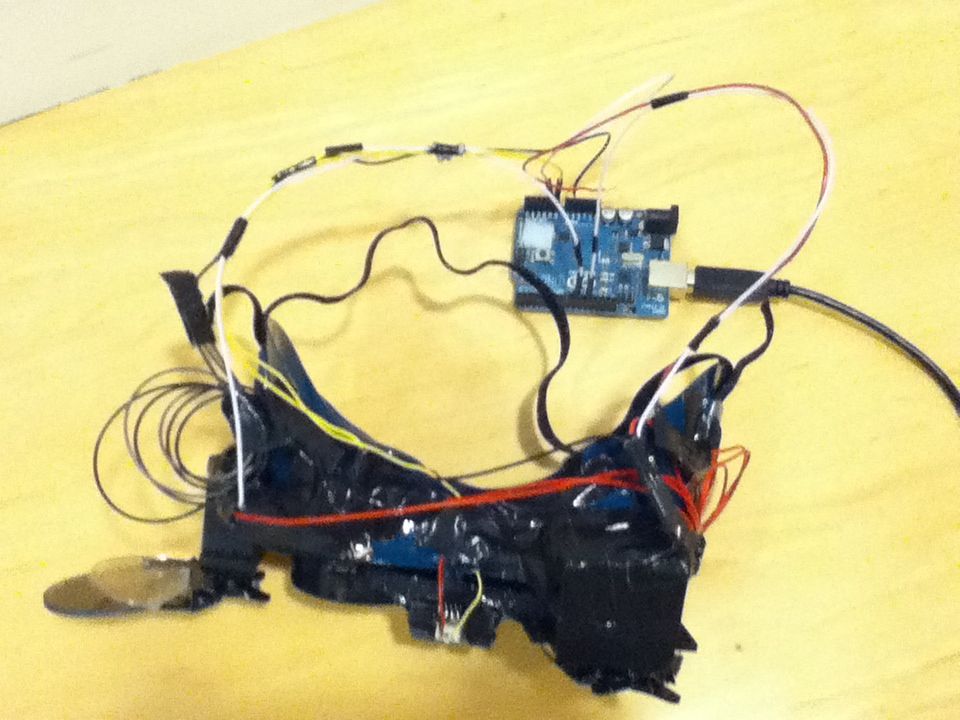

Step 5: Attaching Laser, Photodiode, Arduino & Camera
Once you have the wood frame assembled, you can slap on components, right? Right.
Photodiode and arduino:
Solder two long wires to the two ends of the photodiode. Remember, long leg is typically positive and the flat edge is typically on the negative side. Stick the positive wire into A0 of the arduino, and the negative wire into GND. Push the photodiode into the hole you drilled in the side of the frame (Photo 1).
Laser:
Push the laser pointer through the hole. It should shine directly into the spot where the photodiode is on the other side of the frame. The point of the laser and photodiode is to recognize when there is a word block above the camera (it should interrupt the beam of the laser to the photodiode). Make sure the laser is pointing into the photodiode. If it is not, re-drill the holes to work out. Use modeling clay to hold the laser in place (Photo 2).
Camera:
We cut a hole in the shape of our camera in the bottom (Photo 3) so we wouldn't have to worry about it moving around. You're on your own here. I don't know what shape your camera is.
