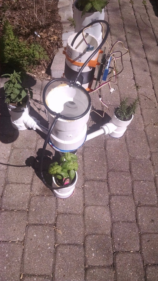

Step 3: Assemble Base Row
The base row consists of 3 pods mounted in a triangular formation and level to the ground thus providing stability for the Smart Garden Urban model (the slide adjustable collar with 3 holders is used for the base row).
Step 4: Additional Growing Pods and Irrigation Line
Each pod comes with an 'irrigation ring' which fits on the pod ledge and is connect to via tubing to an upper level pod. The Smart Garden Urban model is designed with a 2 pod second tier. Additionally, in this sample model, one of the second tier pods is equipped with 'sun light leds' and is designed to extend directly over one of the first level pods.
