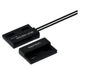

- - Contact Reed (MK21P-SET)

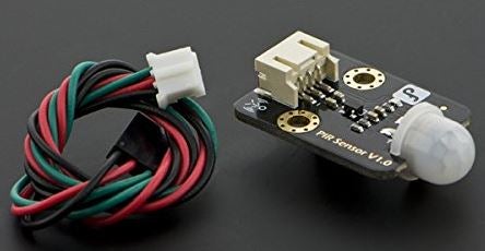

- - PIR (ziyun Digital Capteur PIR)

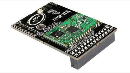

- - Razberry Board for Zwave communication with raspberryPI

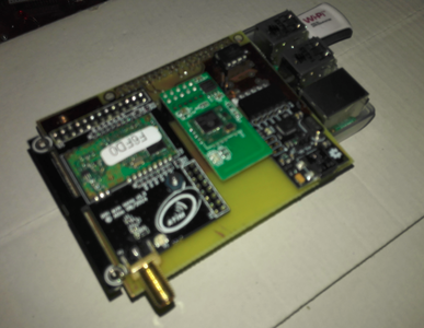

Step 2: Let's Get Started With the Central

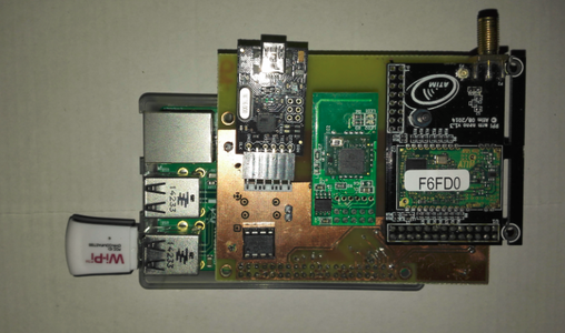

The basis of our system is a raspberry pi 2 to which we add the communication Sigfox and Zwave. We have developed an expansion card that allows us to connect our various modules to the GPIO pins of our raspberry pi.
To set up the Zwave server, follow the tutorial on the site:
http://razberry.z-wave.me/
The tutorial will allow you to create the link between the razberry module and the raspberry pi. Be careful to format the server so that you can add your various sensors to the Zwave network.

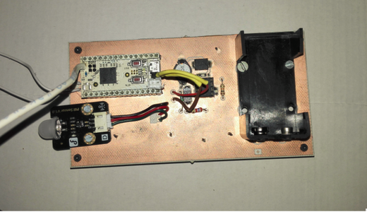

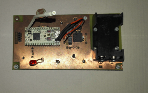

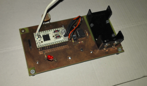

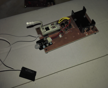

Step 3: Create Your Own Module

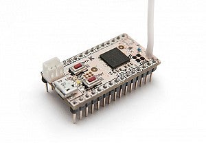

You can now create your own module. To do this we use Z-UNO development cards:
https://z-uno.z-wave.me/
These cards allow you to use the Zwave protocol without purchasing the operating license. The libraries are easy to use and will allow you to use the card very easily. Nevertheless it must be taken into account that it is only a development card and one can not do everything with.
