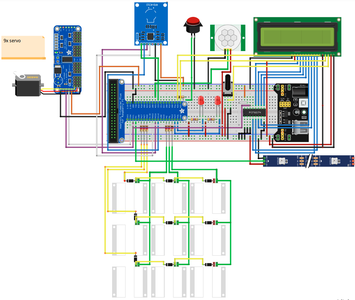

Step 2: Circuit Diagram
Step 3: Magentic Readswitches
To detect if a cabinet has been opened or closed, you will need some magnetic read switches. You could wire all the 9 individually up to the pi but then you will need 9 gpio pins. Intead, it is better to use a matrix so you'll only need 6 gpio pins. To protect the pi, place a resistor of 1k ohm at each gpio pin, also you will need to use some diodes, otherwise the current will flow to the pi using the other switches and you won't be able to see wich one has been opened if you open multiple cabinets.

Step 6: Connecting Everything Up
Now you will need to connect everything to the raspberry pi, see the fritzing scematics at the start of this page. To complete the housing, you will need to 3D print the following items below:
