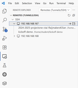

Step 2: SSH Connection in Visual Studio Code
To control your Raspberry Pi from your laptop without using a separate monitor or keyboard, set up an SSH connection in Visual Studio Code using the Remote - SSH extension.
Steps:
  1. In VS Code, go to the Extensions tab and install Remote - SSH.
  2. Make sure SSH is enabled on your Raspberry Pi (sudo raspi-config ➜ Interface Options ➜ SSH ➜ Enable).
  3. Ensure your laptop and Pi are connected to the same network.
  4. Press F1 in VS Code → choose Remote-SSH: Connect to Host... → type pi@<your-pi-ip-address> (e.g., pi@192.168.0.123).
Once connected, you can write, edit, and run code remotely on your Pi, without needing to touch a mouse or keyboard on the Pi itself.

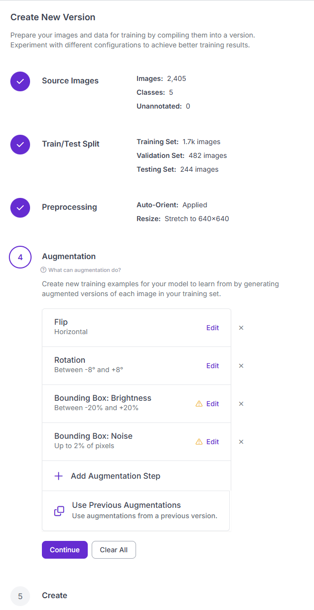

Step 6: Creating Dataset Version
Once I finished labeling all the images, I used Roboflow to generate a new dataset version. This process allowed me to apply data augmentations like flipping, rotation, and brightness changes to improve the model's robustness.

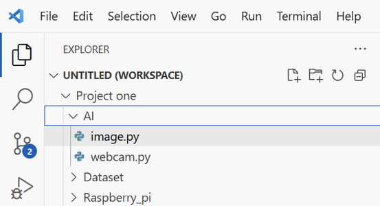

Step 8: Organizing Project Structure in Visual Studio Code
To keep everything clean and manageable, I created separate folders in Visual Studio Code. This makes it easier to find files, debug issues, and work more efficiently.
Here's the folder structure I used:
  1. dataset → for code related to downloading, training, evaluating, and tuning the YOLO model
  2. ai → for the YOLO-based webcam detection script
  3. raspberry_pi → for the code running on the Raspberry Pi that handles the external monitor display
Keeping everything well-structured not only saves time but also helps avoid confusion when switching between different parts of the project.

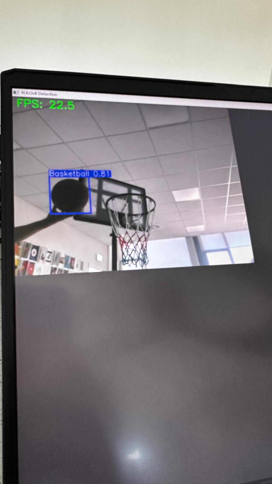

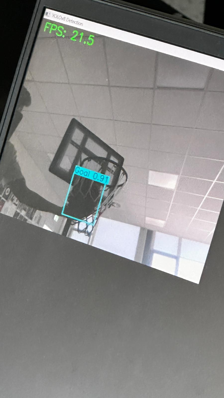

Step 11: Making Webcam Code for Realtime Detection
After training the model, it was time to put it into action using a webcam for real-time detection. I created a Python script that uses OpenCV to stream video frames from my webcam and pass each one to the YOLOv8 model I trained. The model detects outcomes like “goal,” “rim hit,” or “miss,” and I overlay those results on the screen using bounding boxes and labels.
To make the system more responsive and avoid counting the same action multiple times, I implemented a cooldown mechanism. For example, when a goal is detected, the system waits 2 seconds before it can count another goal. I also added logic to prevent false misses—for instance, if a basketball is seen but no goal follows, it counts as a miss only after a short timeout. Additionally, if a rim or backboard hit happens but isn’t followed by a goal, it’s automatically converted to a miss after 2 seconds. This logic helps ensure the counters reflect accurate, real-world outcomes and keeps the display system clean and reliable.
NOTE!This is a general explanation of how the code works. The most up-to-date and fully functional version can be found in the GitHub repository linked in the final step.

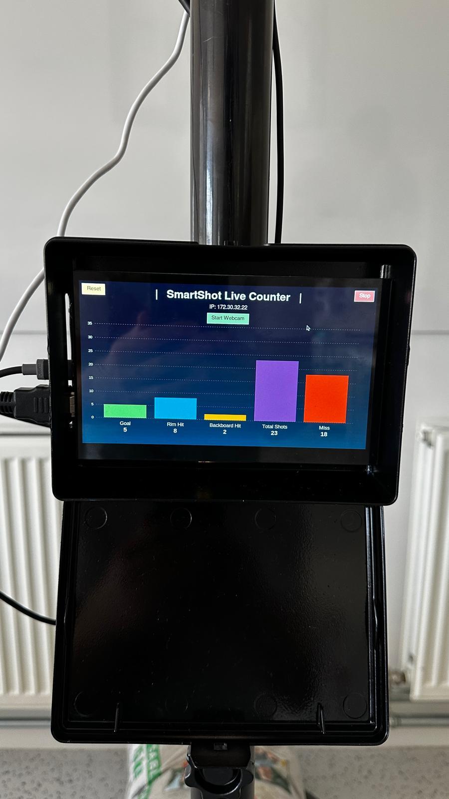

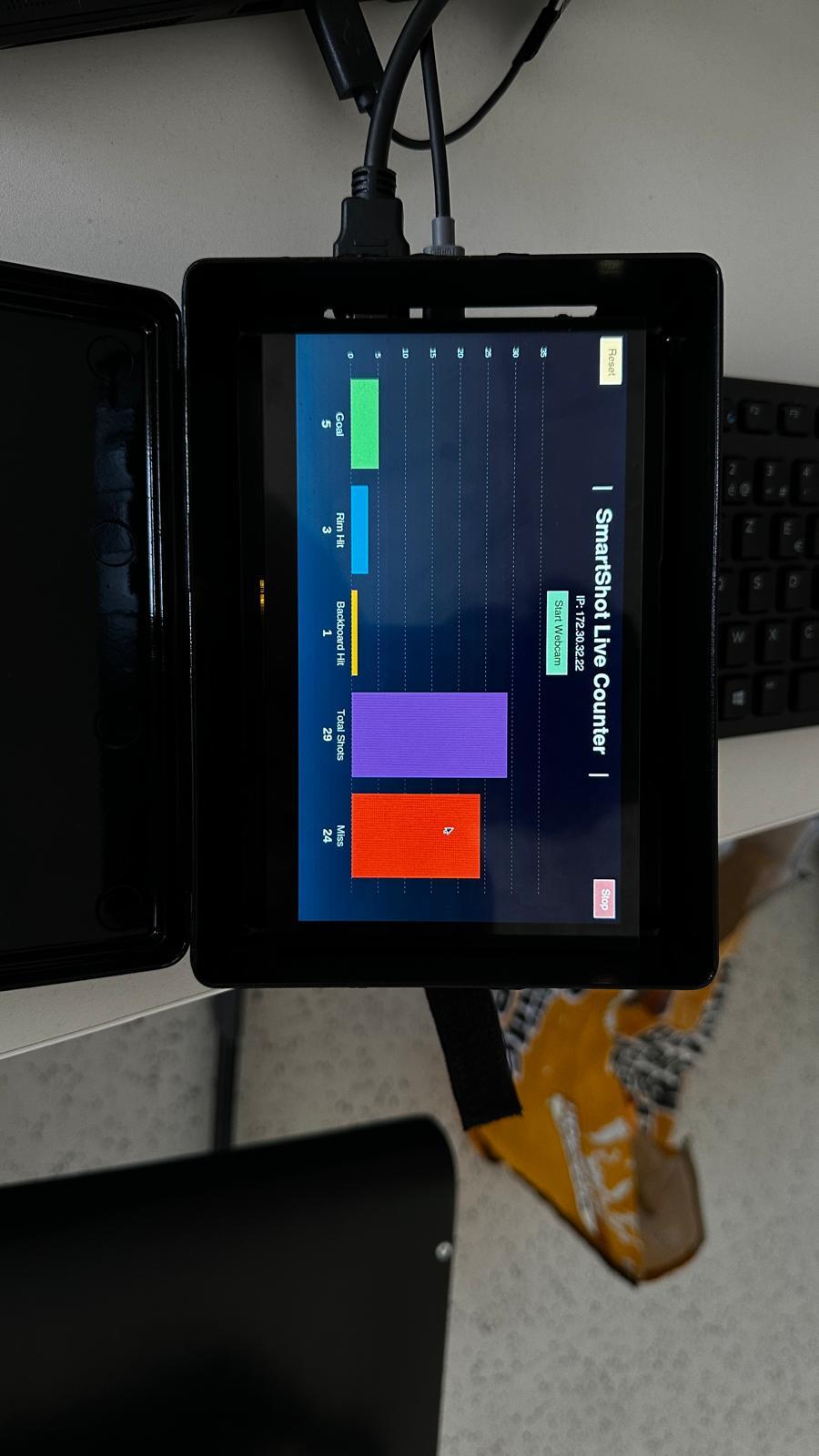

Step 12: Installing the Monitor
For this step, I connected the monitor to the Raspberry Pi for the first time to test how everything looked and functioned visually. I powered everything up and made sure the display turned on correctly and filled the screen as expected. I checked the clarity, brightness, and positioning of the monitor to ensure it would be easy to read during live use. This test was mainly to confirm that the monitor setup was working reliably before moving on to integrating the real-time code and detection visuals.

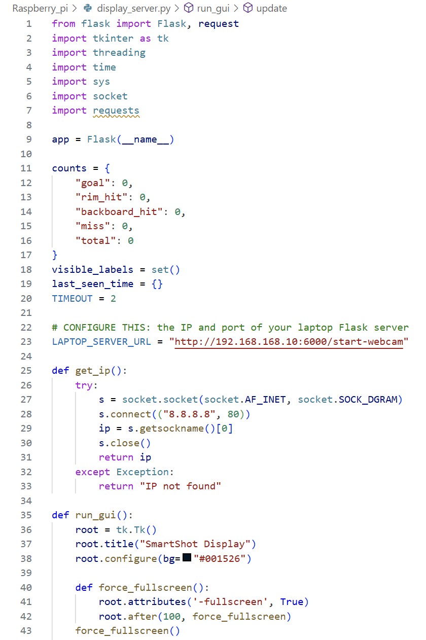

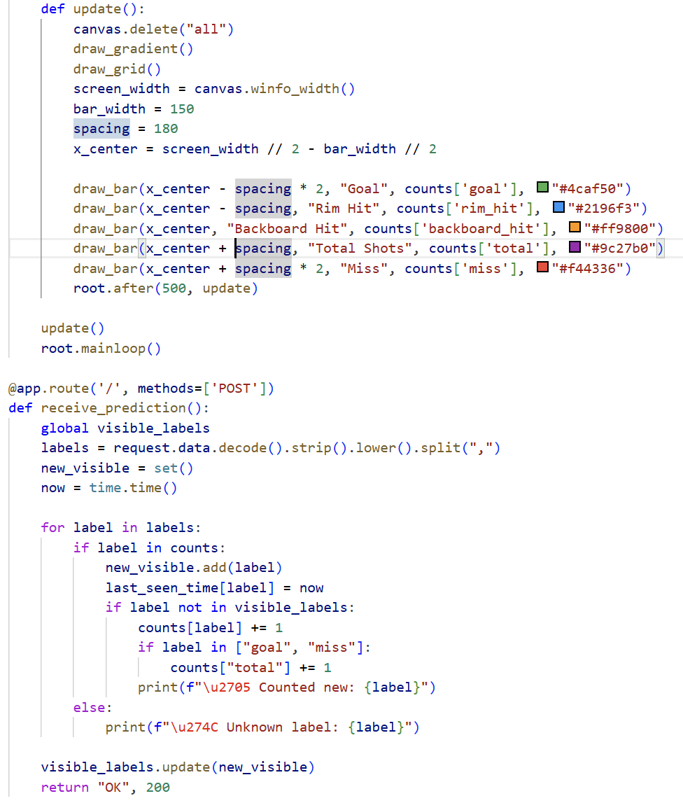

Step 13: Making Code for Monitor on Raspberry PI
In this step, I programmed the Raspberry Pi to run a fullscreen graphical interface that displays live basketball shot statistics. I used Python with the tkinter library to build the GUI, which shows a bar chart for goals, rim hits, backboard hits, misses, and total shots. Each bar updates in real time as new events come in. To make communication possible between the Raspberry Pi and my laptop, I included a small Flask server that listens for POST requests sent by the detection system running on my laptop. When a new event like a goal or miss is detected, it sends a request to the Pi, which updates the corresponding counter on the monitor.
I also added a feature to display the IP address of the Raspberry Pi at the top of the screen, making it easier to connect devices on the same network. Buttons were added to the GUI to reset all counters, stop the program, and even remotely start or stop the webcam code running on my laptop. This is done using requests.get() to trigger endpoints on the laptop’s Flask server. Additionally, I created a watcher_loop in a background thread to remove old labels after a certain timeout, keeping the state clean and responsive. This step was crucial in bringing everything together visually and letting me monitor the SmartShot system live on the Pi’s connected screen.
NOTE!This is the general logic behind the monitor control script. For the most recent and polished version, please check out the GitHub repository linked in the final step.

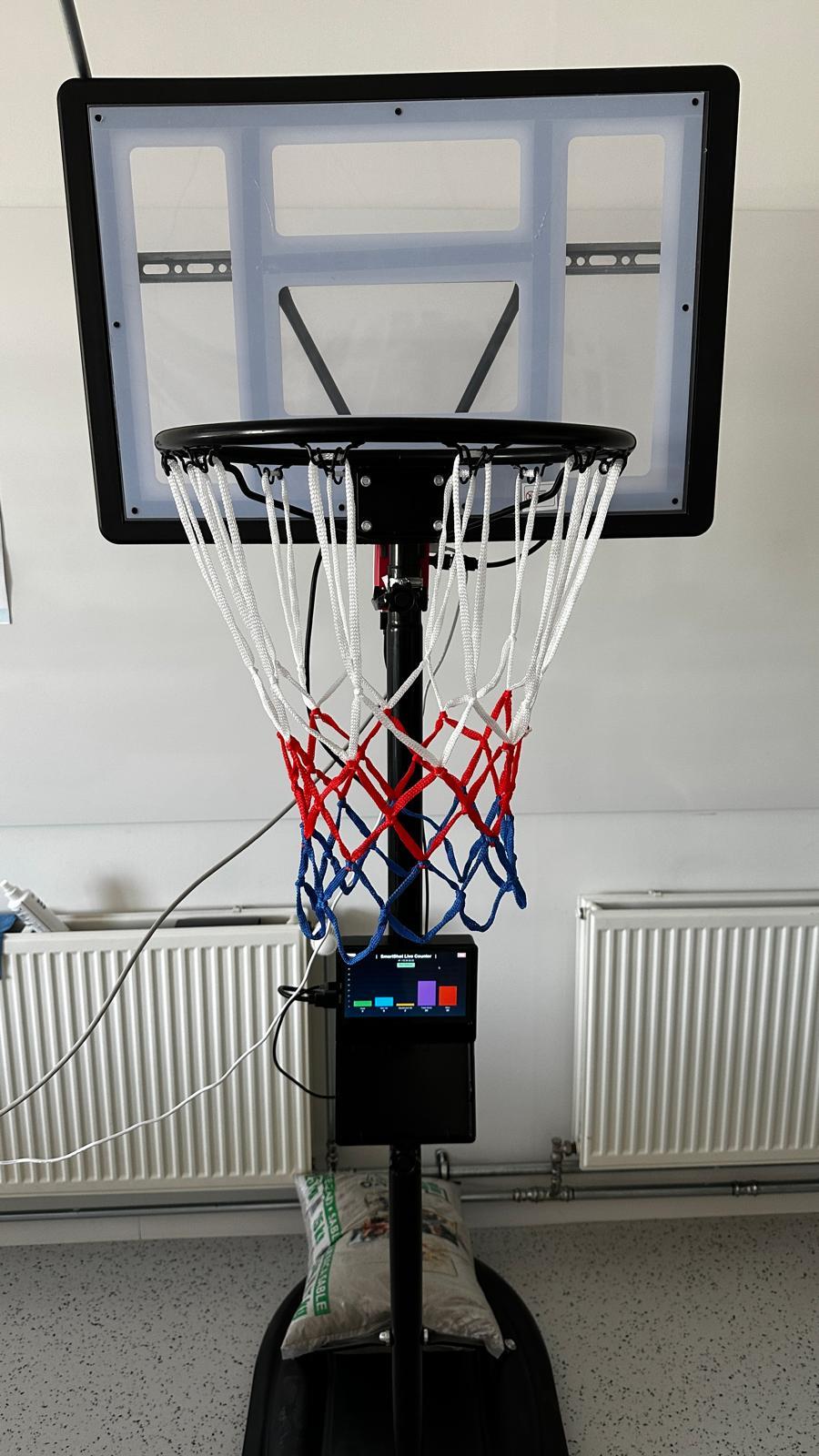

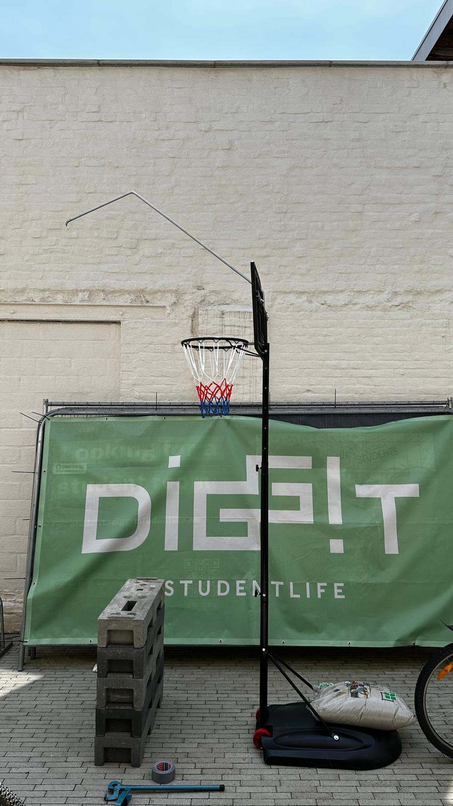

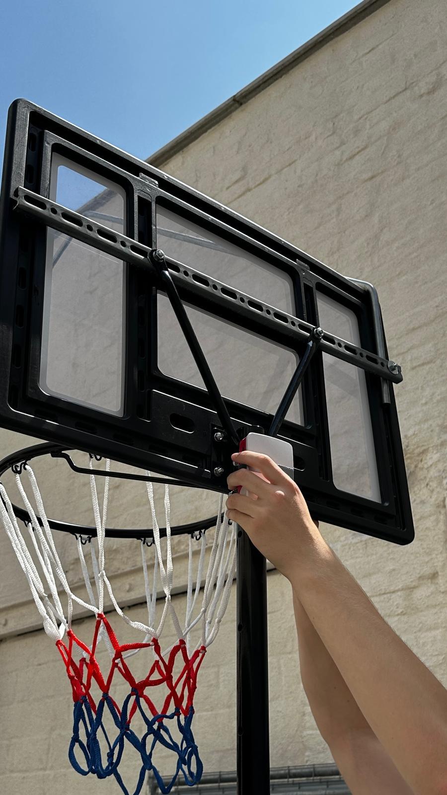

Step 14: Building the Basketball Hoop
Before I could fully test the SmartShot system, I had to install the basketball hoop itself. This step involved securely mounting the hoop at the correct height and ensuring it was stable enough to handle repeated shots. Once the hoop was in place and everything was aligned properly, I was finally ready to move on to full system testing.
Step 15: Test the Model
After setting up the monitor interface on the Raspberry Pi, I moved on to testing the entire SmartShot system in action. I placed the camera to face the basketball hoop and began shooting while monitoring the real-time feedback on the screen. The model successfully detected goals, rim hits, and backboard hits, and correctly triggered misses when no successful shot was detected. I paid close attention to how responsive the system was, making sure the cooldowns I had implemented worked properly, so that the same shot wouldn’t be counted multiple times. This step was essential to verify the accuracy and timing of the detection model, and to ensure that every event translated correctly to the live statistics shown on the Pi monitor. It was really satisfying to see everything working together, from the webcam detection to the real-time updates and interaction between devices.

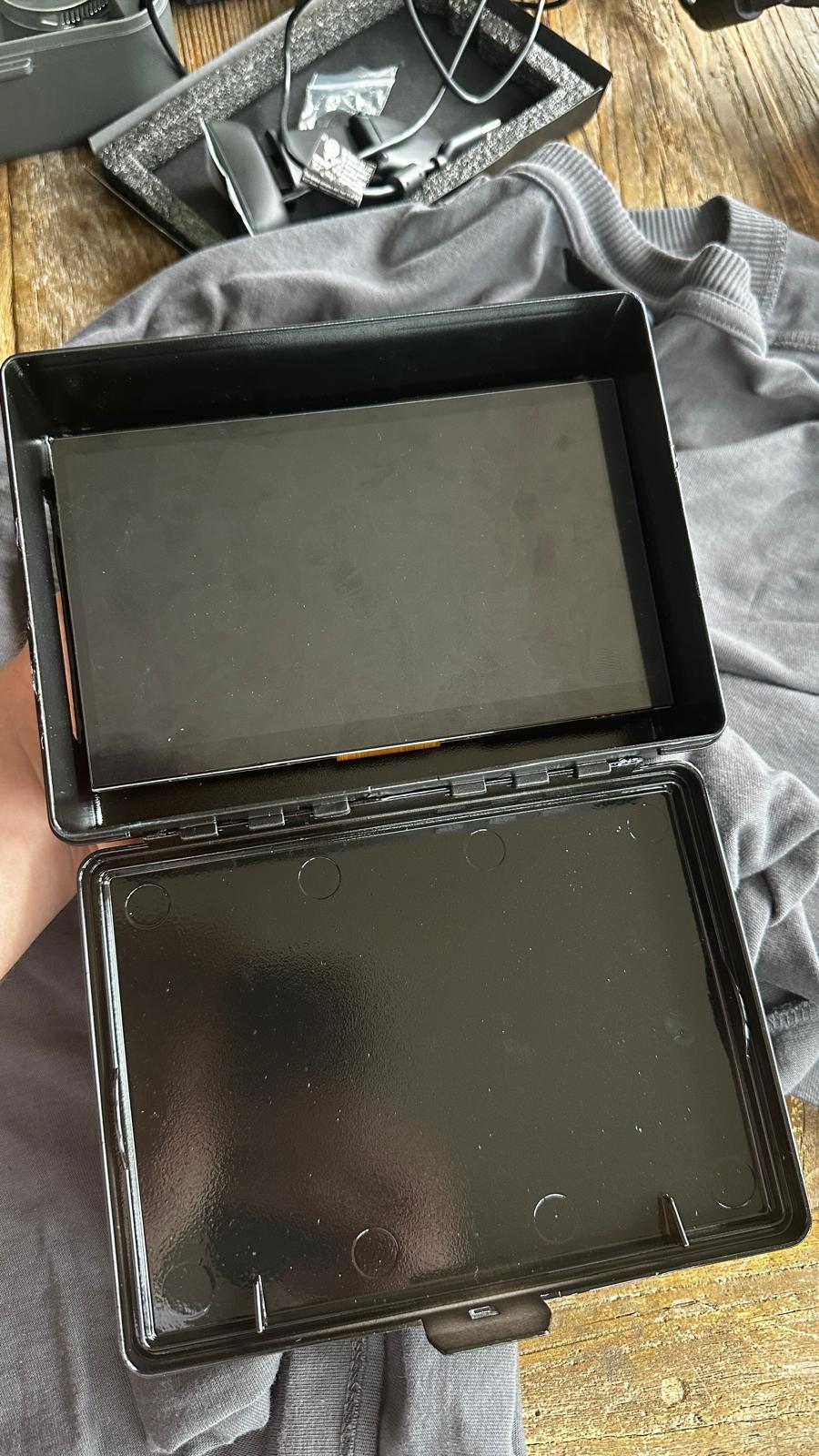

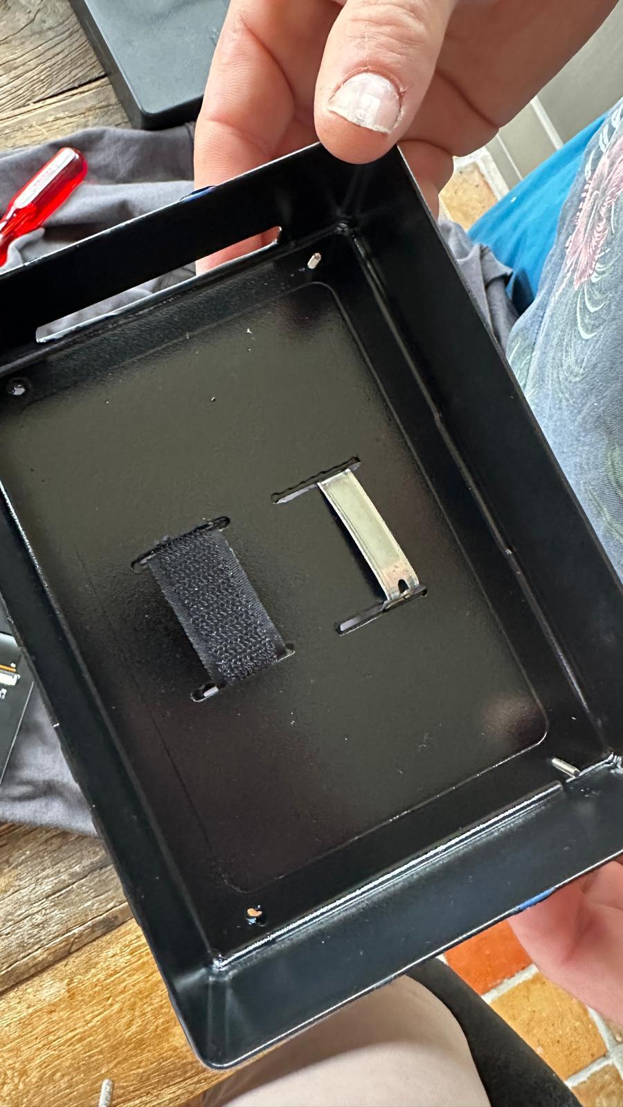

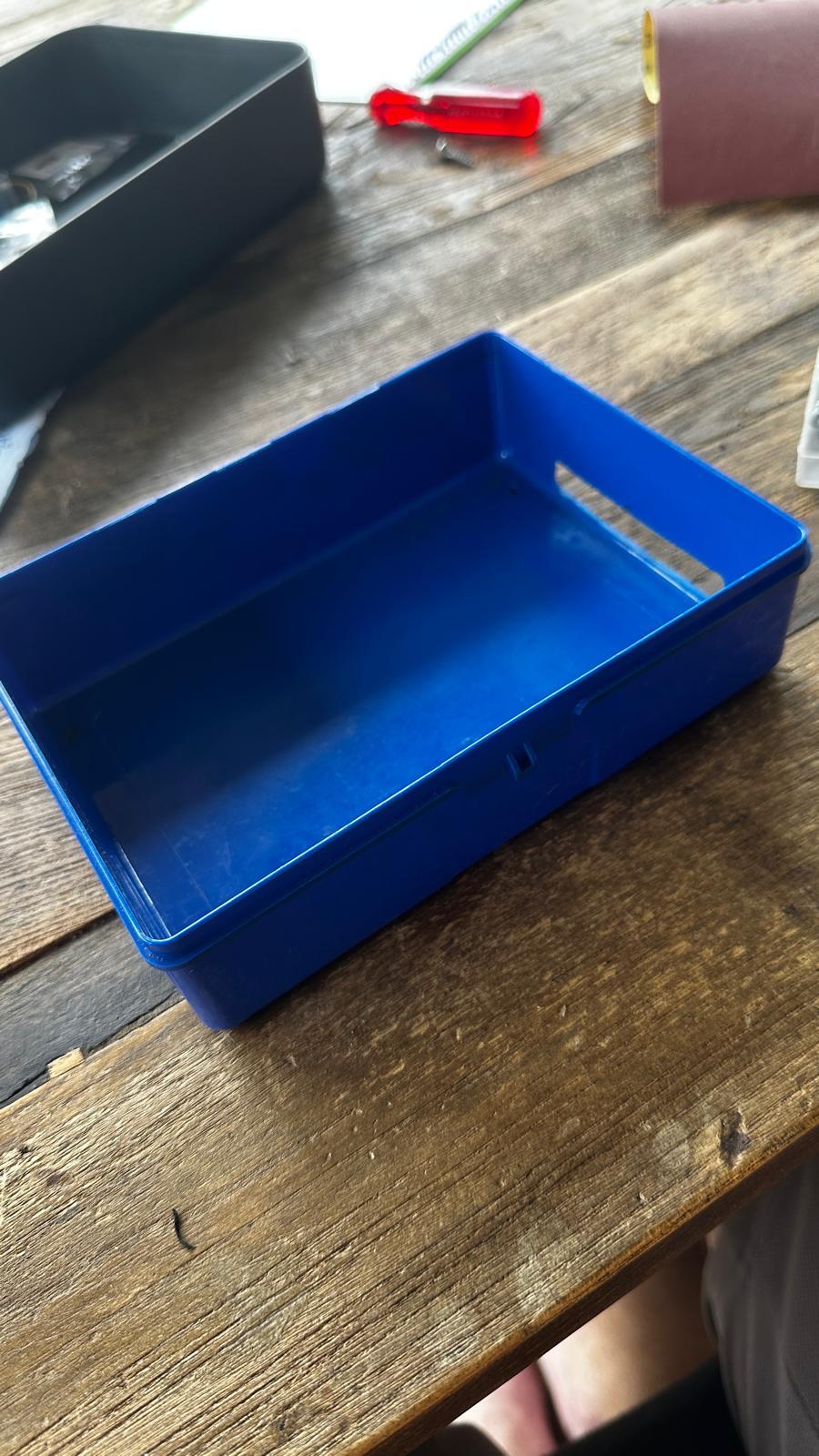

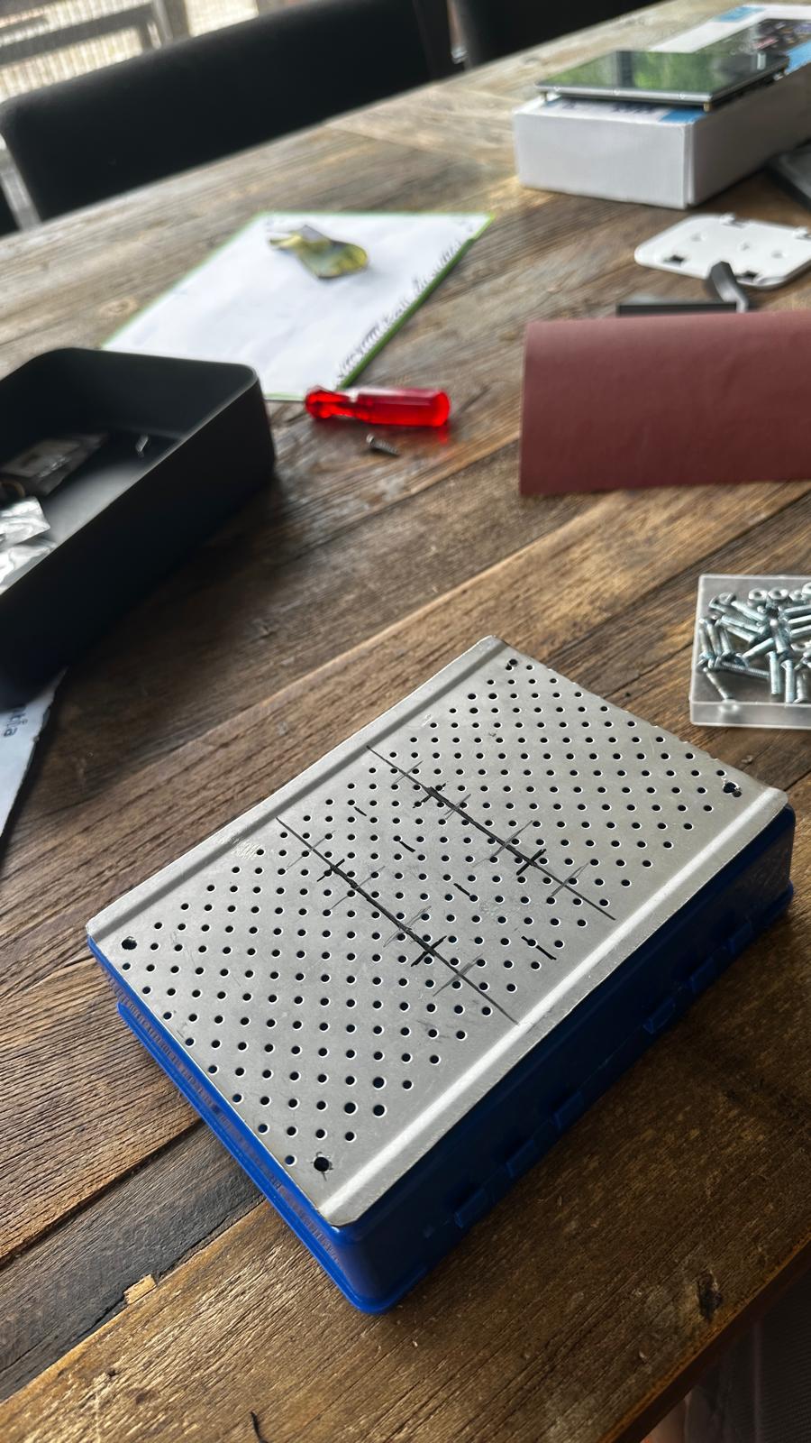

Step 16: Making Box for Monitor
To protect the monitor and mount it securely outdoors, I decided to repurpose an old first-aid box as the base. Here’s how I transformed it into a functional enclosure:
  1. Measuring and Marking Screw Holes
I started with a basic plastic first-aid box and placed the monitor inside to measure exactly where the screw holes needed to go. This ensured the monitor would fit snugly and stay firmly in place once mounted.

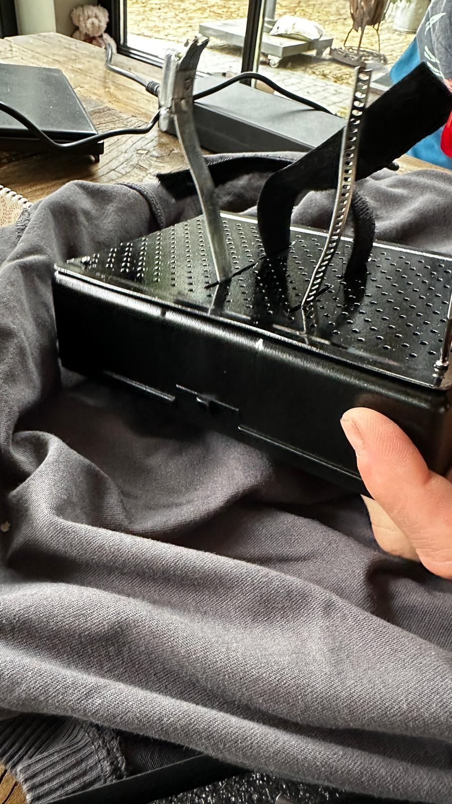

  1. Cutting a Support Plate
I cut a rectangular metal plate to match the outer dimensions of the box. Then I drilled matching screw holes into this plate. The plate adds extra support and distributes the mounting pressure evenly, preventing damage to the box or monitor.
  1. Creating Cable Access Opening
Next, I measured and marked where the power and HDMI cables would need to enter. Once marked, I carefully cut a groove/opening in the side of the box to route the cables neatly into the monitor.
  1. Making Mounting Slits for Velcro
To make the box mountable on the basketball hoop’s vertical pole, I added 4 slits in the back. These slits allow velcro straps to pass through and hold the box tightly against the pole.

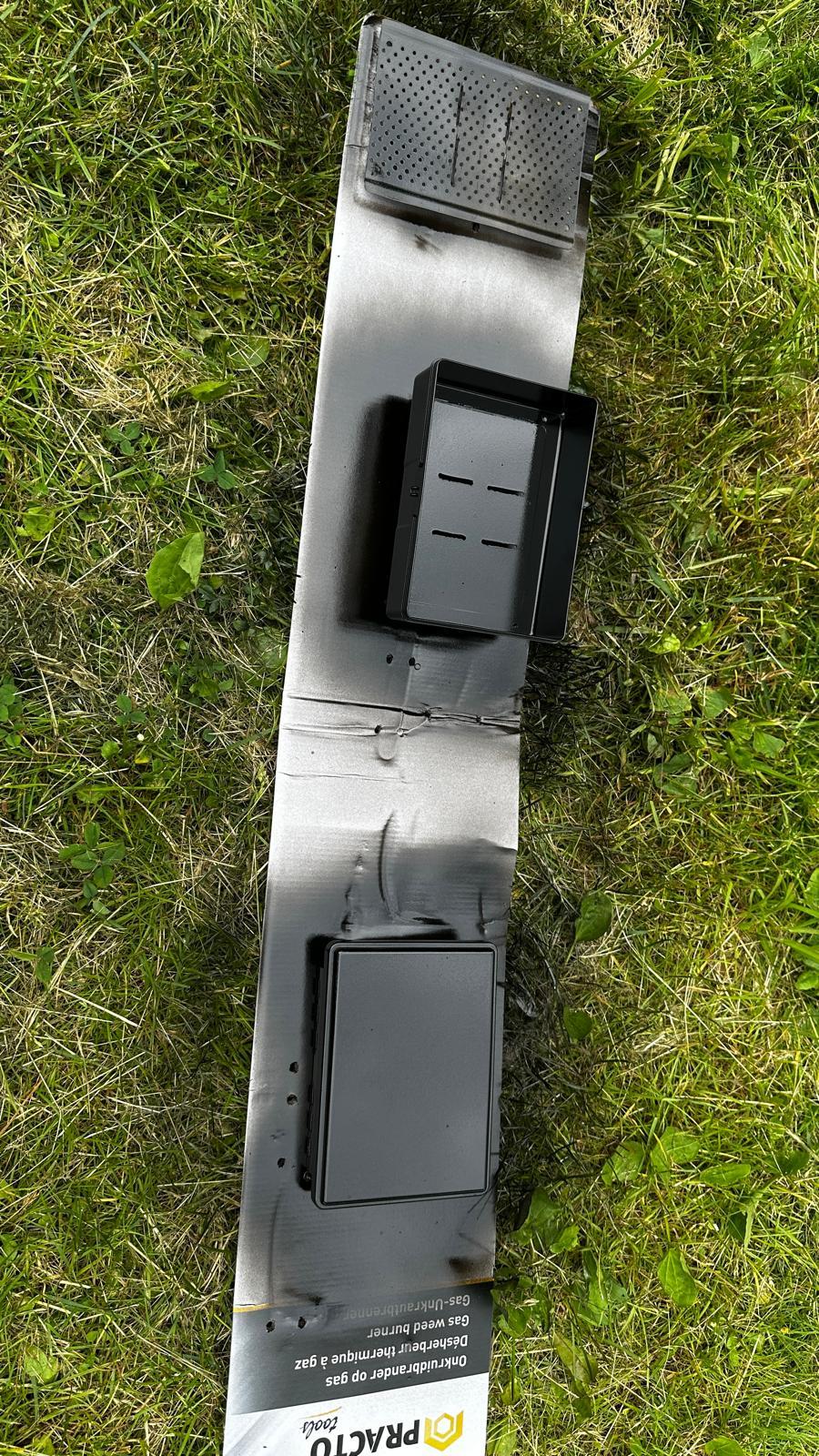

  1. Sanding for Paint Prep
With all the functional cuts made, I sanded the outside of the box thoroughly. This helped the paint adhere better and removed the glossy finish from the plastic.
  1. Spray Painting the Box
I then spray painted the entire box black to match the rest of the SmartShot setup. I let it dry overnight to make sure the finish was smooth and fully set.
  1. Final Assembly
Once dry, I attached the metal support plate to the outside, threaded the velcro straps through the slits, and mounted the monitor securely inside using screws. The result was a mountable display case for my monitor.

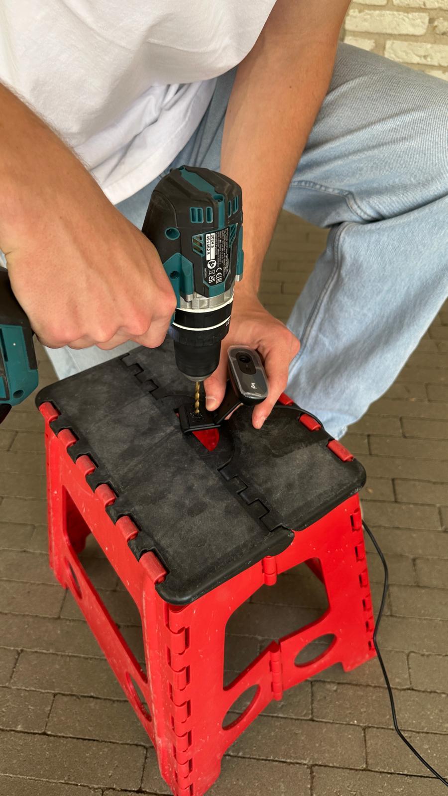

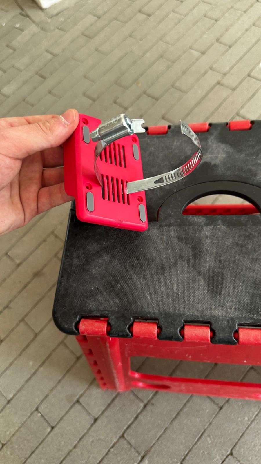

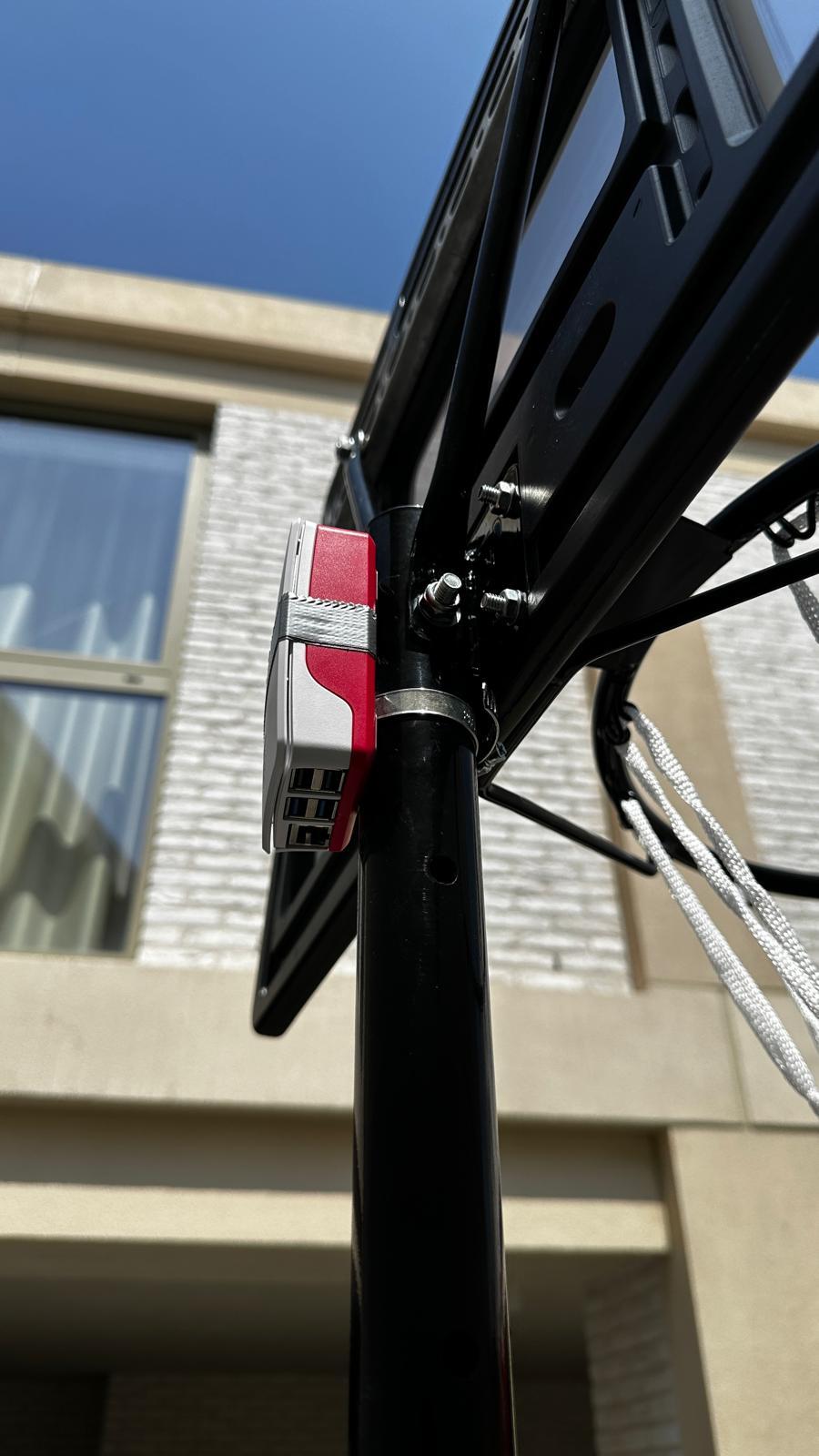

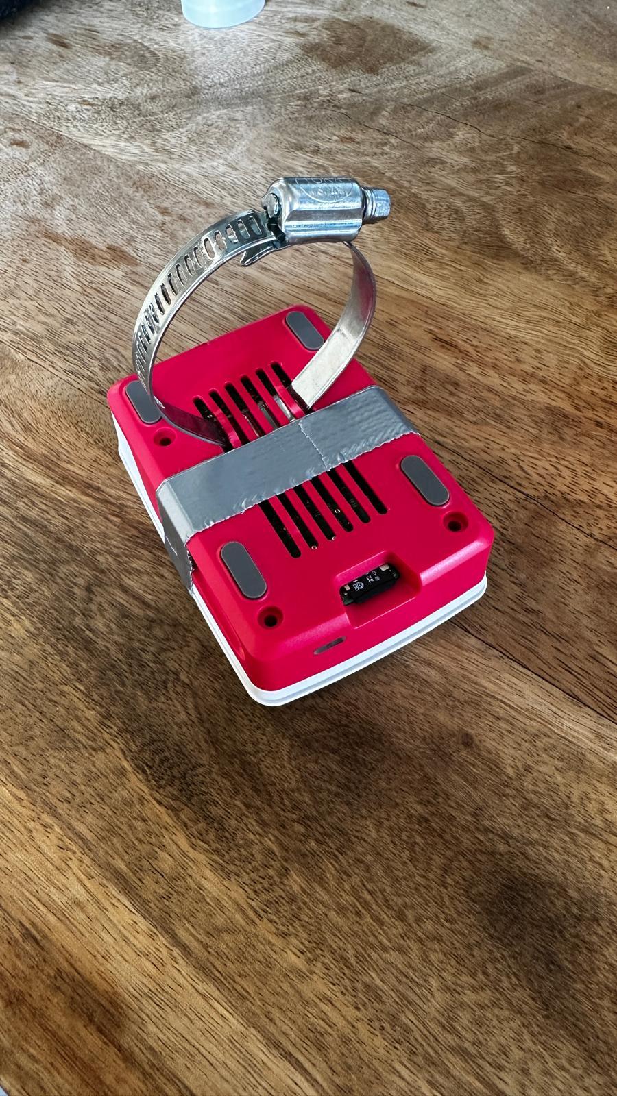

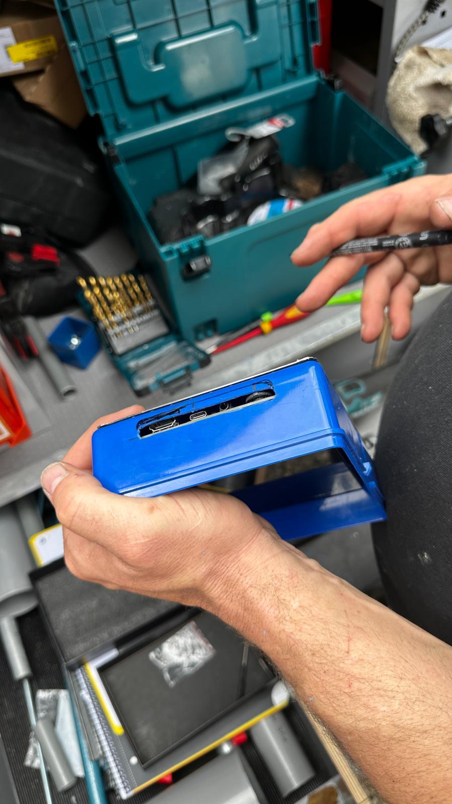

Step 17: Making Box for Raspberry PI
To protect and mount the Raspberry Pi securely to the pole, I used a plastic Raspberry Pi case and modified it for mounting. I started by grabbing a strong metal hose clamp that could wrap around a vertical pole. I then manoeuvred the clamp through the bottom of the Pi case.
Once the clamp was in position, I clicked the Raspberry Pi board into the case and snapped it shut. Since the setup would be mounted to the basketball hoop and exposed to movement, I reinforced the case by wrapping it with duct tape to ensure it stayed firmly closed and the Pi remained safely in place.

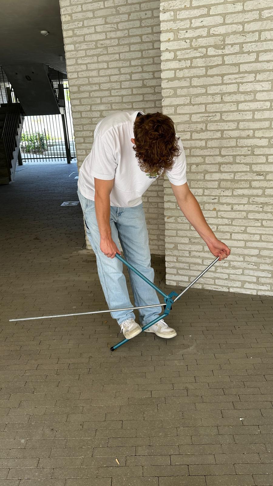

Step 18: Making Pole for Mounting Camera
1. Bending the Metal Pipe
I started with a long metal pipe that would serve as the camera mount. To get the right viewing angle and distance from the backboard, I had to bend the pipe. The curve ensures that the camera sits far enough from the backboard to capture the hoop and surrounding area clearly.

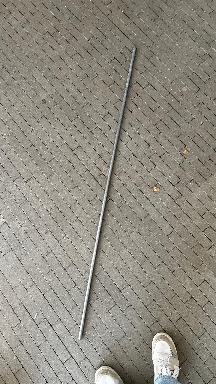

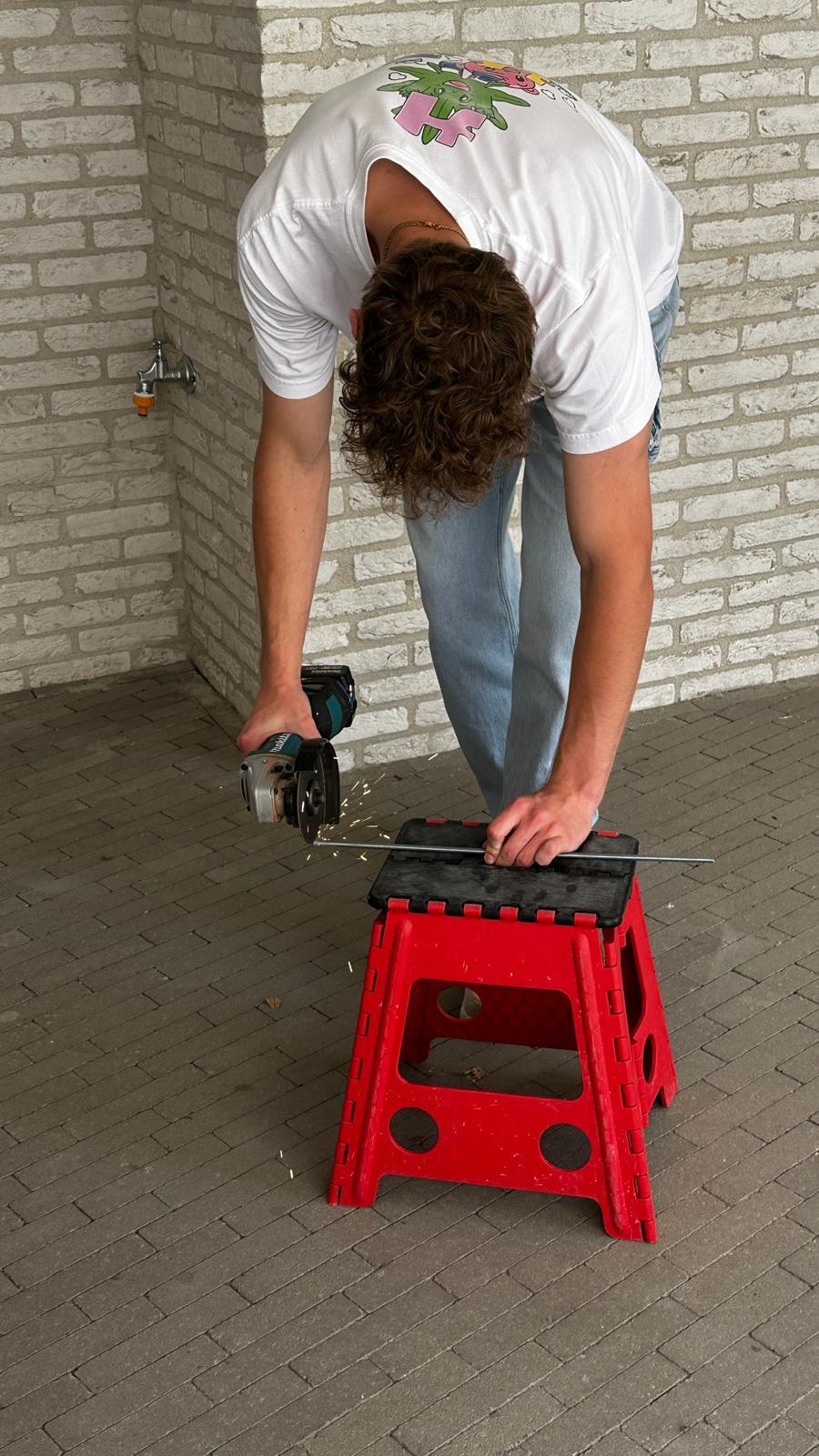

2. Making Custom Bolts from Threaded Rod
The original bolts included with the basketball hoop were too short to support the added construction. To fix this, I cut a piece of threaded rod into two custom bolts of about 5 cm each. These provided the perfect length for securely attaching the mounting system.
3. Preparing the Flamco Rail
Luckily, I had a Flamco mounting rail that fit the width of my backboard perfectly, so I didn’t need to cut it. If you’re building this yourself, you may need to cut your rail to fit your backboard dimensions.
4. Mounting the Flamco Rail
I attached the Flamco rail firmly to the back of the backboard using the custom-cut threaded rods and nuts. This rail acts as the main support structure for the camera pipe and ensures stability during use.
5. Attaching the Pipe to the Rail
Finally, I drilled a hole through the bent metal pipe and mounted it securely to the Flamco rail. This created a strong, elevated arm to hold the camera in the correct position for basketball shot detection.

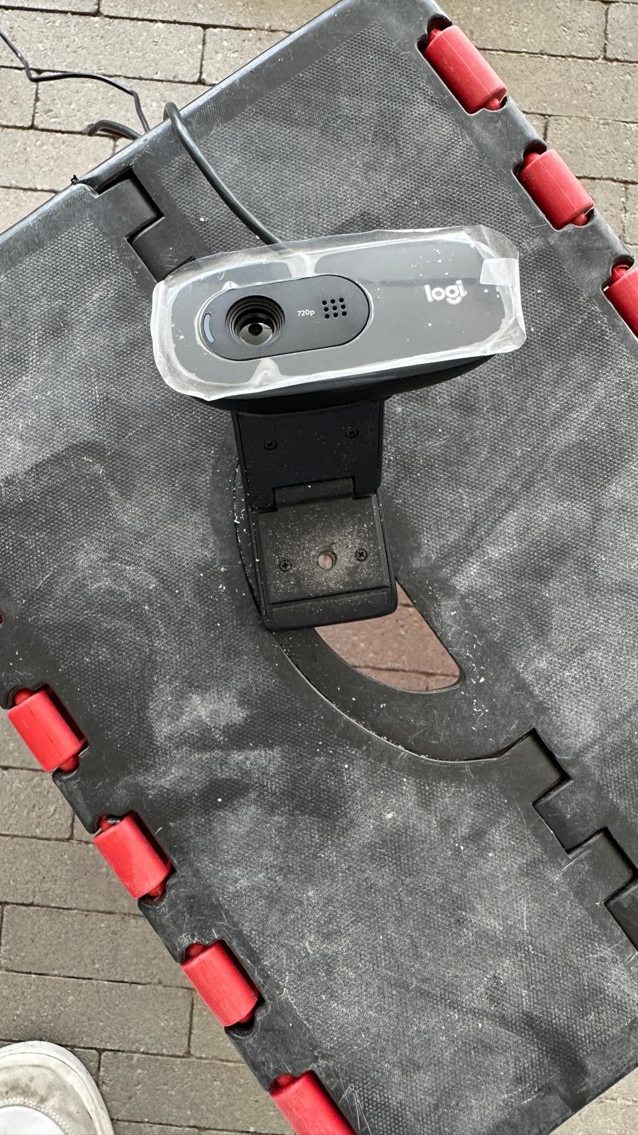

Step 19: Mounting Camera to Pole
1.Drilling a Hole in the Webcam Mount
I began by drilling a hole into the base of the webcam mount so that I could screw it onto the support structure later. The hole needed to be centered and tight enough to keep the webcam stable once mounted.
2.Preparing the Mounting Pole
Before attaching the camera, I had to slightly pinch (flatten) the bent end of the metal pole. This gave me a flat surface to work with and allowed the camera mount to sit flush. Once it was flat enough, I drilled a matching hole into the pole so the screw could go through both the pole and the camera mount smoothly.
3.Aligning and Attaching the Camera
After both holes were ready, I aligned the webcam mount with the pole and inserted a screw through the drilled holes. I used a nut on the back side to fasten it tightly and securely.
4.Final Securing
With everything aligned, I held the webcam firmly in place and tightened the screw. The result was a stable, reliable camera setup facing the basketball hoop, ready for real-time AI detection.

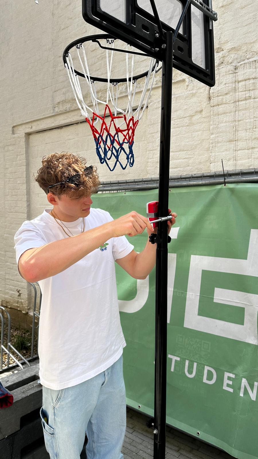

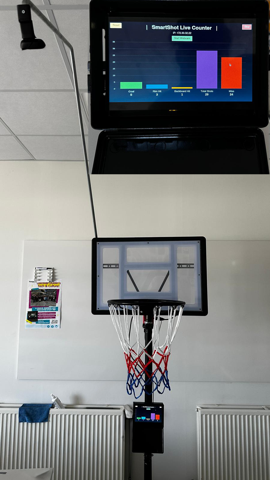

Step 20: Installing Everything on the Basketball Hoop
First, I mounted the pole to the backboard, which I already prepared in Step 18. Then I attached the Raspberry Pi case securely to the pole using the hose clamp. After that, I mounted the monitor box to the pole. With everything in place, I connected all the necessary cables between the monitor, Raspberry Pi, and camera. The full SmartShot setup was now installed.
Step 21: Play Ball! 🏀
With everything set up and connected, it was finally time to shoot some hoops and enjoy the SmartShot system in action. The camera, model, and monitor all worked together to give real-time feedback. I hope you have just as much fun building and using your own version, enjoy your creation and have fun playing!
