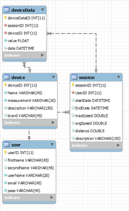

Step 4: Database Structure
This step is purely informational for the people who want to edit my database.
