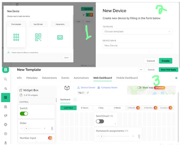

Step 3: Create New Blynk Project
On Blynk:
  1. Press on new device
  2. Choose From template
  3. Insert template and device name
  4. Enter to your device
  5. Press edit
  6. add Switch and Slider and connect them to virtual pin.

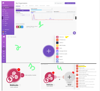

Step 4: Integromat
On Integromat:
  1. Press on Create new scenario.
  2. Click on the "+" button.
  3. Search Webhook
  4. Choose Custom Webhook
  5. Press on 'add module'
  6. Search 'Gmail'
  7. Choose 'send an email
  8. Use this tutorial in order to connect your gmail - tutorial

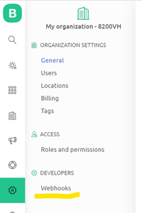

Step 5: WebHook
On blynk:
1. Press on setting -> Webhook
2. Change the the Webhook name
3.Choose the device that you want to connect
4. Choose a the virtual pin under "DATASTREAM" section
5. Paste the URL of the Integromat's Webhook under "URL" section.
6. Press on Save Webhook
