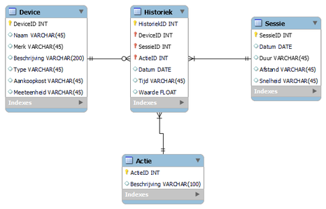

Step 2: The Database
I've made a database so i could store the data of all my sensors and the sessions. You can download the database dump from below.

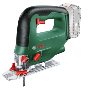

The first thing we're going to do is make holes in the nose of the skateboard for the distance sensor, the hall sensor and the lcd screen. I drilled the holes for the distance sensor with the kind of drill from picture 2. I cut the hole for the lcd screen with a jigsaw, but you can also make holes with a drill and cut out the rest with a saw. Between the distance sensor and the LCD is a hole for the lDR who you can just drill. You can place the led strip wherever you want, but I put it on the side of the box. The last part is the hall sensor. You need to place the hall sensor on the trucks and I taped it on. What you also need to do is put the magnet on the side of the wheel so that the hall sensor can read it as it passes by. note, you need to pay close attention to which side of the magnet it reads in and which one it doesn't. The hall sensor measures the plus on one side and the minus on the other side of the magnet. For the box that holds the electronics, I used a regular box that I attached to the skateboard with screws. The battery is attached with a regular strap that I stapled in place so you can replace the battery or take it out to charge.
