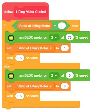

Step 14: The Graphical Code
To code the hovercraft easily, we are going to code it in PictoBlox- graphical programming software.
The main block is used to connect the Smartphone via Dabble and call out the required blocks when the condition in the if arm is true.
This block calibrates the ESCs.
This block will control the Lifting Motors(start or stop).
This block will control Thrust Motors(start or stop).
