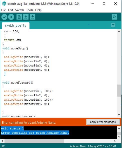

i am unable to compile the code its getting
{exit status 1
Error compiling for board Arduino Nano.}
this error while compaling the code .
pls help me to resolve this problem

SwatiY2
SwatiY2
Reply 2 years ago
Download the Arduino library completely
