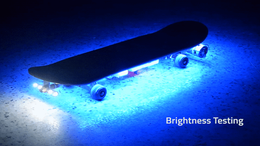

Step 6: Adding Custom Brightness Headlights and Bodylights
We have added some good looking neon lights as shown in figure. and some big LED's of sufficient brightness. We have used the motor driver for this work. By setting different PWM for motor 2 that is attached to lights we can change the brigtness of the light.
