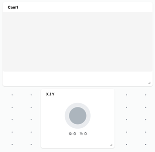

Step 2: Create Dashboard
Create Project & Dashboard
  1. Go to https://app.grablo.co
  2. Click "Create Project"
  3. Name your project
  4. Create a new dashboard
Add Widgets
  1. Camera Widget: Create a new camera with default settings.
  2. Joystick Widget: Create X and Y variables, assign to joystick. Keep min/max at -100/100.
💡 Tip: Adjust mobile dashboard layout for smartphone control. You can fine-tune it later on your phone.

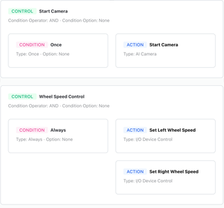

Step 3: Create Logic
Control 1 - Start Camera
Start the camera once when the project begins.
  1. Condition (Once): Run once at startup
  2. Action (AI Camera): Start camera, leave AI Analysis empty
Control 2 - Motor Control
Control wheel speeds based on joystick input.
  1. Condition (Always): Run continuously
  2. Action 1 (I/O Device Control): Set left motor speed
  3. Action 2 (I/O Device Control): Set right motor speed
Motor Speed Formula
For differential drive steering without a servo:
  1. Left wheel: Y + (X × 0.4)
  2. Right wheel: Y - (X × 0.4)
The 0.4 ratio prevents overly sensitive turning. Adjust to your preference.
