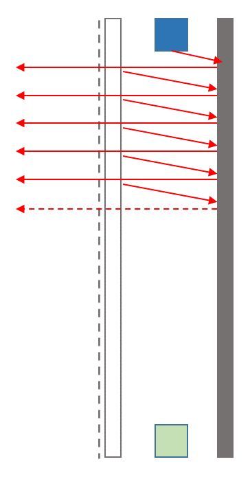

An infinity clock uses multiple reflections between a mirror and a semi-reflective mirror to give the illusion of great depth while it is only one centimeter deep!
The time is indicated by LEDs that reflect many times between these interfaces and give this impression of depth.
Multiple reflexions give the impression of depth

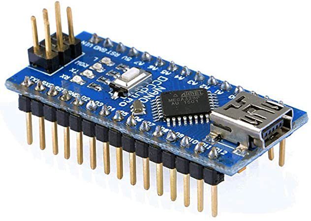

- An Arduino nano (2 USD)

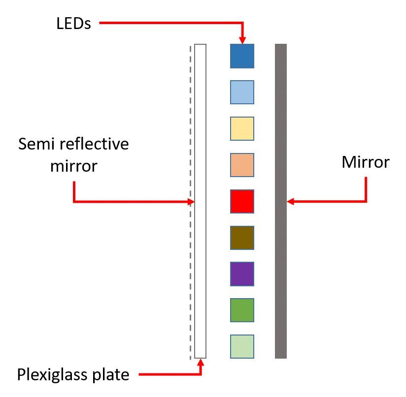

Diagram of principle of the clock's geometry
The plexi plate should be 2 to 3 mm thick so it stays firmly in place when in use.
The diagram above explains the geometry of the clock. The led strip is placed in between the two mirrors. Of course, you need 60 of those leds on the strip. You can find online led strips with 60 leds per meter, so one of those is good. Then the perimeter of the led circle being 1m, its diameter is 100/PI = 31.8 cm (approx. 12.53 inches).

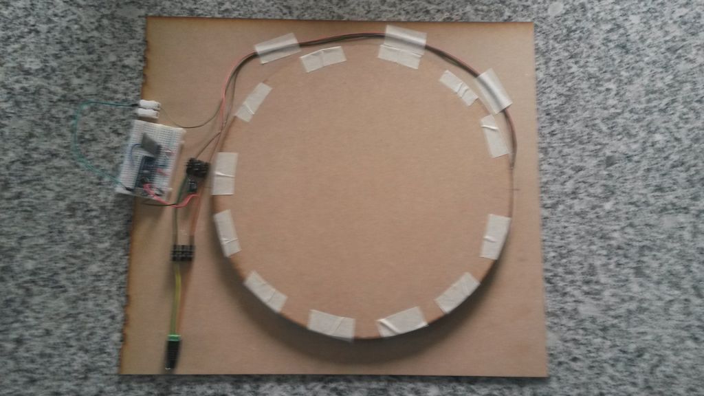

First, glue the mirror film on the MDF disc. It will be the bottom of the clock.
Second, stick the semi transparent film on the plexiglas disc. This forms the front glass of the clock. This disc will be inserted in the MDF plate, in the circle hole : glue it using wood glue if necessary, or use silicone rubber.
Last, prepare the LEDs. WS2812 LEDs use 3 connexion pads: voltage supply, ground and command. If there are already 3 electric wires connected, just use them. Otherwise solder 3 wires to the connexion pads. Remember that LEDs are polarized devices: this means that the current flows in only one direction. This direction is indicated on the strip with an arrow. Then, you should solder the wires at the end of the strip from where the arrows come (not the end to which the arrows point).
Stick the LEDs inside the thick MDF cylinder and assemble the 3 parts, with glue and / or tape.
Then the electronic part
Put the Arduino in the breadboard and create the circuit as shown above. Make sure all grounds (GND) are connected (GND from Arduino, HC-05 module, LED strip and supply).
- The RX and TX pins of the HC-05 Bluetooth module are connected to the pins D3 and D2 of the Arduino
- The data line of the LED strip is connected to the pin D12, you can insert a 300 Ohms resistor in between if you have one.
If you want to change the pins, change their definitions in the code accordingly (lines 7 and 13 of the ino file).
Note that the HC-05 module requires a voltage divider for its RX pin, as shown below. So you need one 1000 Ohms and one 2000 Ohms resistors.
The supply is used both for the Arduino and the LED strip. First connect the 1000µF capacitor in a screw terminal (domino). You can use quick connector if you have some. See here for more details.
This capacitor may also be polarized: make sure the + and - legs are connected to the + and - of the supply. As can be seen on the image of the capacitor, the - leg is labelled with a big minus sign.
Then from the connector, plug electrical wires to connect the LED Strip and the Arduino board. As said above, all GND should be connected together. From the positive potential of the supply, connect the 5V wire of the strip and draw a wire to the 5V pin of the Arduino: leave it unconnected for the moment, you will connect it at the end.
Check everything... twice
Check all connexions twice... Use a multimeter if you have one to check electrical continuity.
If everything is correct, your clock is almost ready. Do not supply it for now.

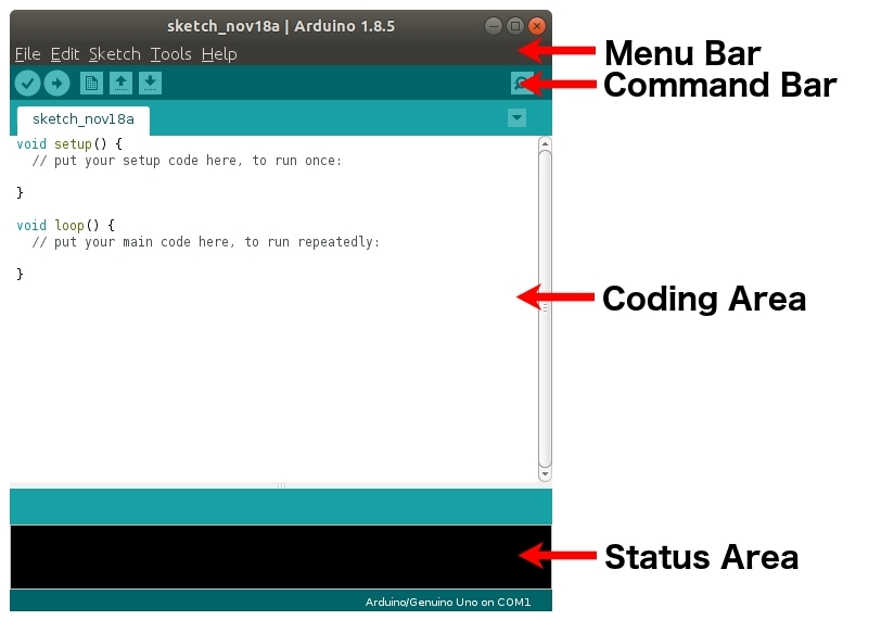

To upload the code in the Arduino nano, use the Arduino IDE. Put all the files in a folder called "Horloge_LED3_nano_BTOK" in your Arduino folder. Open the IDE, select the proper parameters (board type, COM port, etc) and click the upload button.

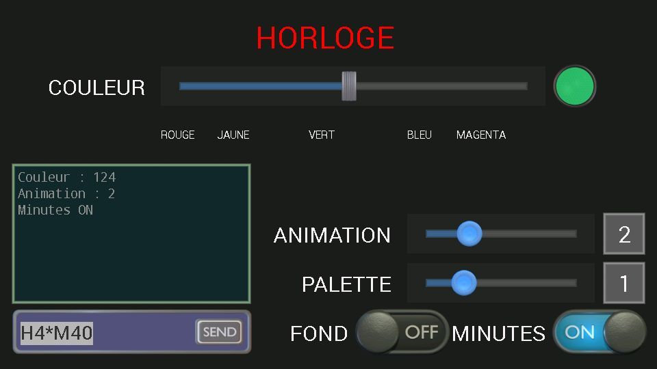

On your Android smartphone, install the Bluetooth Electronics application, you can find it easily on Google Play. Download the file "BluetoothElectronicsCode.txt" from this Instructable, and change the extension to zip : you'll get a zip archive with the code for the smartphone interface to run with Bluetooth Electronics.
When you are ready, plug the supply. The LEDs will light up, the HC-05 module will also blonk to search for the connexion. Launch the Android app and follow the instructions to pair the Bluetooth module with your smartphone. When ready, launch the HMI: you're ready to play!

Now, set the time. This can be done using simple commands that you type in the small console in the lower left part of the HMI.
- Hxx : set the hours to xx (ex: H4)
- Myy : set the minutes (ex: M15)
- Szz : set the seconds (ex: S30)
The commands can be chained by inserting a star between them, for example: H4*M15*S35
Setting hours and / or minutes will reset the seconds to zero.

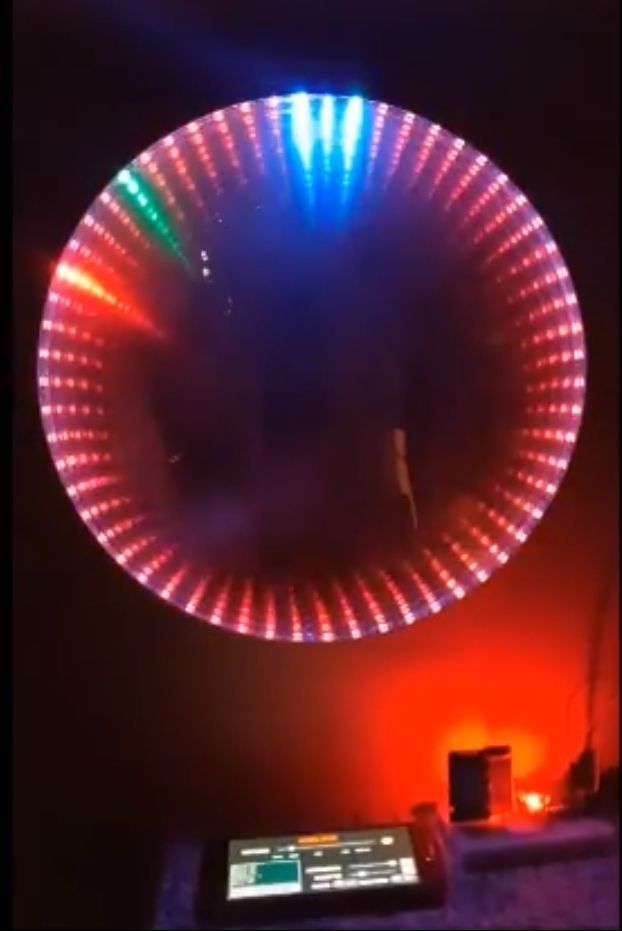

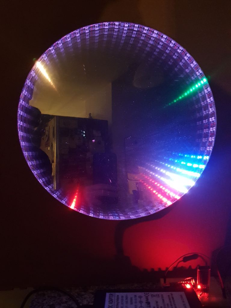

You will then see that the hour is tracked by a RED LED, the minutes by a GREEN LED:
It's 9:52:00!
The colour of the seconds can be changed using the slider on the HMI
When you move the slider, the small circle on the right side shows the current colour. When the slider stops, it sends the colour to the clock and the LED of the seconds changes accordingly.
The ANIMATION and PALETTE sliders can be used to select and customize the light animations on the clock. Test them, and look at the video for some examples. When you change some settings on the HMI, the small console shows the answer from the Arduino.

-- it's 7:11:51
Another animation was recently added, that changes every 15 seconds for a randomly chosen animation.
The MINUTES button switches on and off white LEDs at each 5 minutes on the clock.
It's 7:11:25
Note that the video and photos were made with a smartphone and therefore are of poor quality. The colours are much brighter and more accurate on the clock than what they look like on the video...
