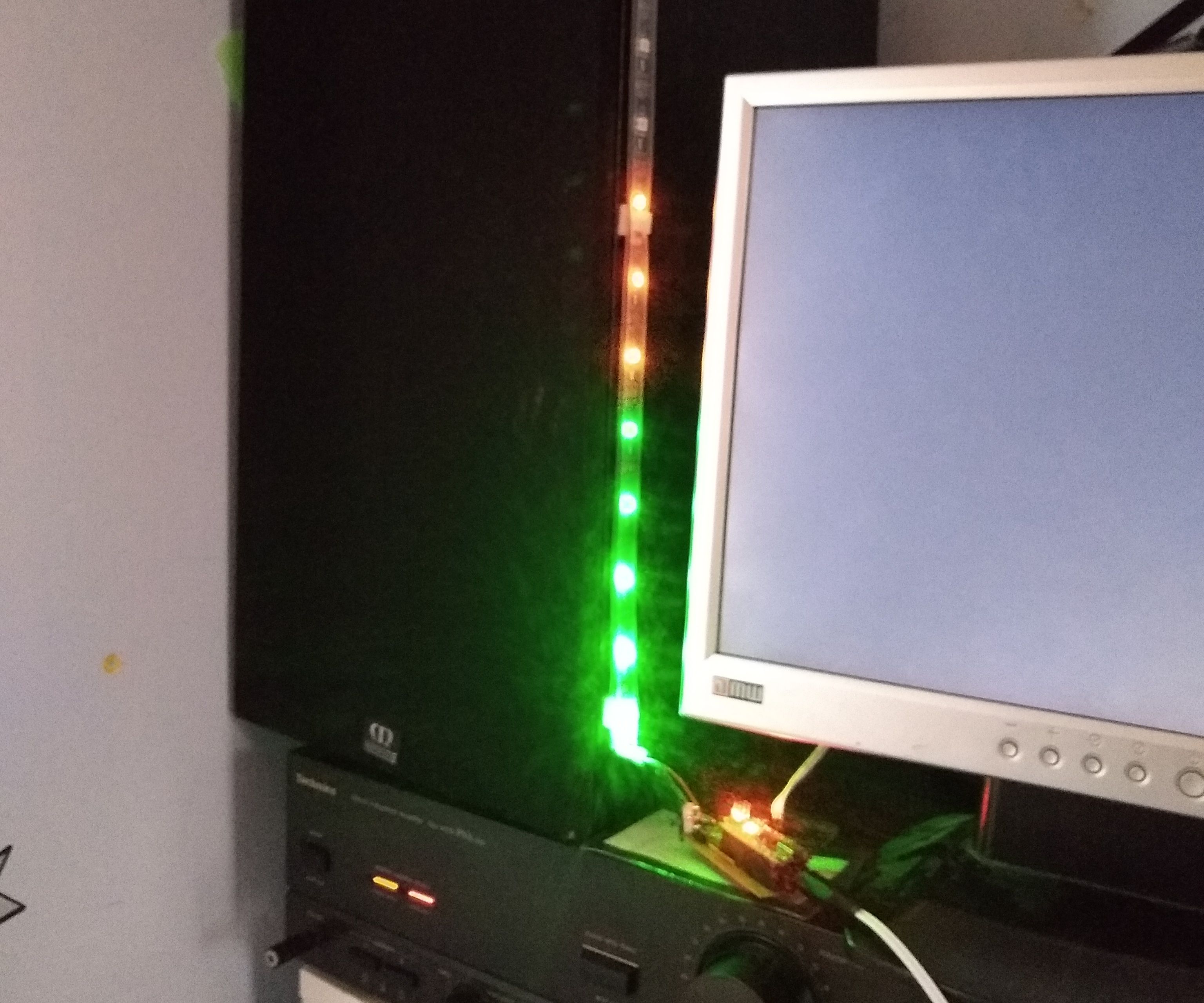

Step 2: Wiring
Connect GND of Neopixels to MCU GND.
Neopixel DATA --> MCU pin D3.
Neopixel +5V --> external 5V power supply (you must connect neopixels to an external supply or they will draw to much current from the controller and fry it, plus the MCU doesn't even have a 5v pin!).
MCU GND --> power supply GND.
Power supply+ --> MCU Vin pin.

Step 6: Finished!
Your project should be ready to use!
Have fun!
