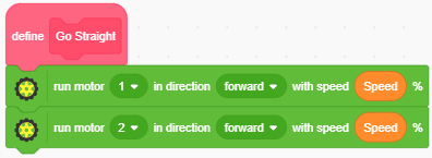

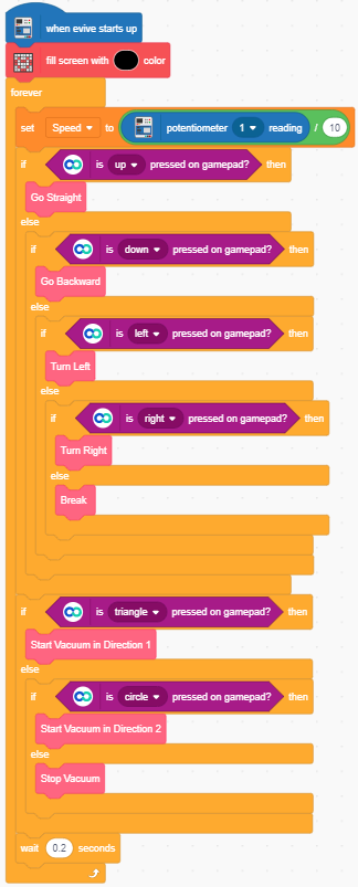

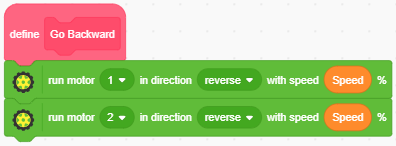

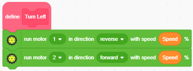

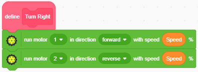

Step 7: Code

You can use your Smartphone to control it.
Open the Gamepad from Dabble.
The Left set of buttons are used for the movement of the robot.
From the right set
- Triangle - Starting the vacuum in direction 1
- Circle - Starting the vacuum in direction 2
If no key is pressed then the vacuum is in a stop loop.
