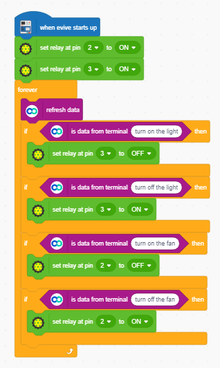

Step 3: Code
Upload the following code to evive
Step 4: Working
When we give the command turn on the light to the Terminal module of Dabble, it sends this string to evive.
Once evive receives the command string, it performs the action corresponding to the string which is written in the code.
The relay is used to switch on/off the lamp/fan.
turn on the light/ turn on the fan - evive sends a low pulse to the relay
turn off the light/ turn off the fan - evive sends a high pulse to the relay
When the pulse is low - relay switches ON the device
When the pulse is high - relay switches OFF the device
