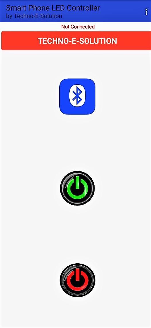

Step 5: APPLICATION
I built this application on a kodular app-making platform. In this app, we simply add two buttons to control the LED using Bluetooth. I provide the app link, you just install the following app.
How to operate the application:-
  1. First power-up the circuit using a 5V DC supply
  2. Turn on mobile Bluetooth.
  3. Search for HC-05.
  4. Pair them with mobile, use password (1234) or (0000).
  5. Now open the application.
  6. Click on the Bluetooth button.
  7. Select HC-05, the Bluetooth will get connect to the mobile.
  8. At the top of the application, you can see the status of the connection, it may be Connected or Not Connected.
  9. Now using two buttons on-screen which are the Green & Red buttons to control the LED.
