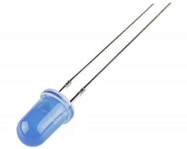

10.A Blue And Red Led (For indicating if the device is cooling or heating)
