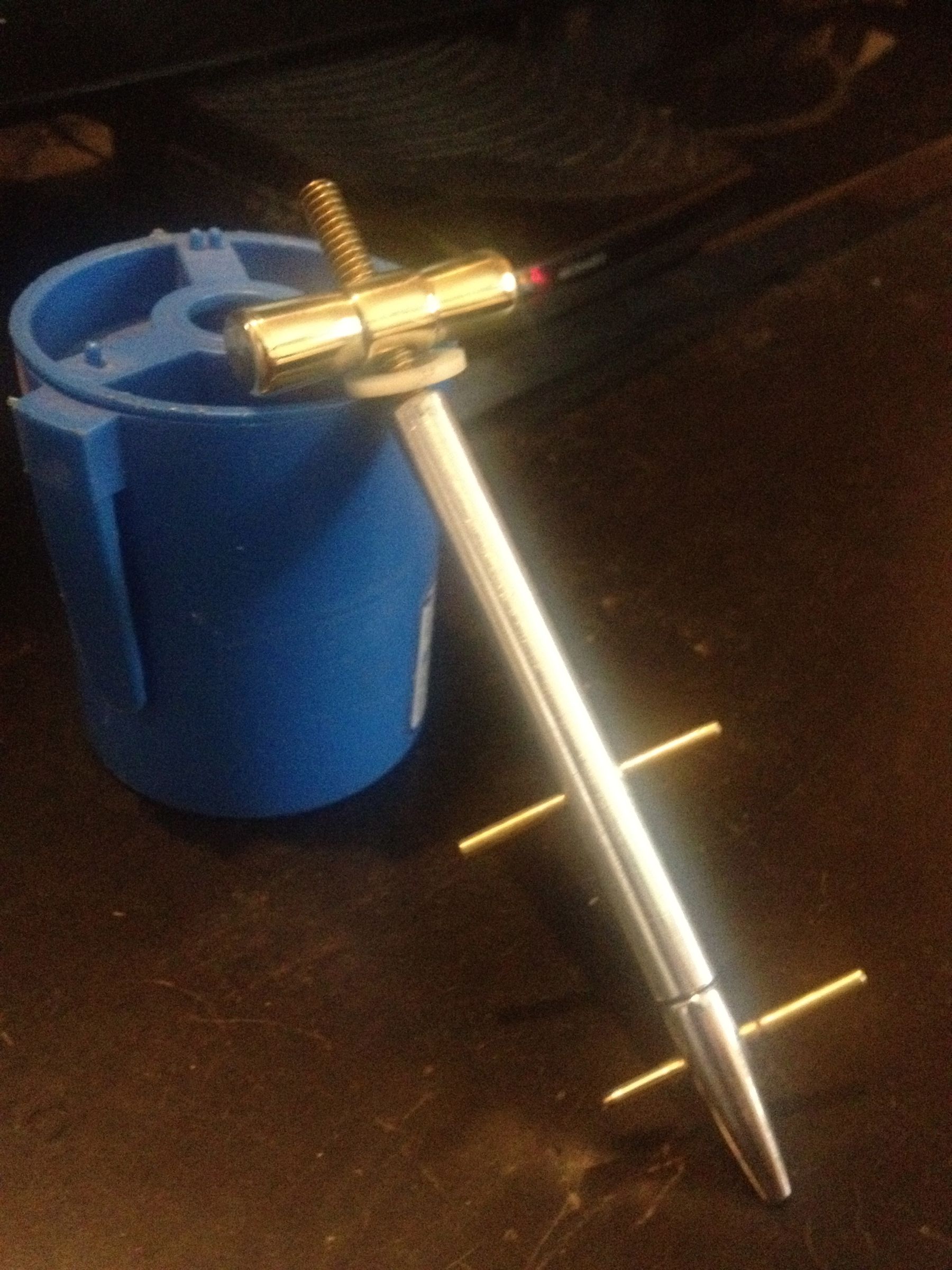

Step 4: Finishing Up!
This is where you clean up all of your edges, sand the piece down and finish shaping it. I have my final shape and fit the front panel around the touch screen.
Now you'll want to find and mark the center line of the adapter. Next, find the centers of the side and bottom of your phone, place it in the adapter and transfer the center marks with your square down to the center line on the adapter. You now have your mounting points for both portrait and landscape modes.
This is where you have to make some decisions as to which way you want to go. Since I won't be using my adapter for anything rough I'm comfortable drilling and tapping the "StarBoard" to mount on the tripod. If you want something sturdier, you can go with threaded inserts for wood and some epoxy.
If you choose my route, drill a 3/16" hole on each mark and carefully tap the holes with the 1/4-20 tap.
