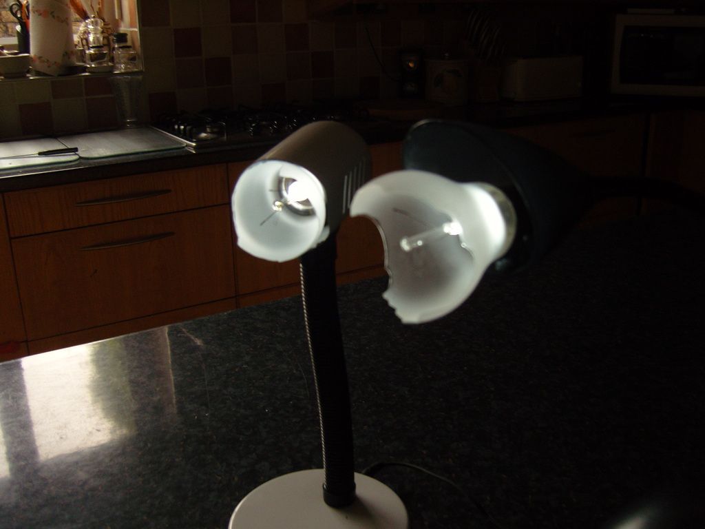

Introduction: Smashed Bulb Lamp MkII
Whilst building my LED version of this lamp i wanted to make the light from the bulb more natural and for the bulb to look more as if it was still working. This is the result.

Step 2: Open the Bulb
Using a cutting disk cut just as the cap is crimped smaller. Do this carefully as the black glass inside will crack
Ease the cap open DO NOT JUST PULL it off, it should still be connected by two thin wires cut these with scissors near to the top and leave connected to the base.

Step 7: Connecting the Bulb
Solder some short wires to the base of the bulb and then cut the pins off at this point. Next solder these wires to the ones connected to the cap of the bulb (detailed in step 2) and check to see if it works. If it does well done if not find out what happened.
Step 8: Sealing It All Up.
Using epoxy resin secure halogen bulb in the base of the cap and then secure the cap to the rest of the bulb.
Step 9: The Desk Lamp
Because i wanted the smashed bulb to be visible I cut the cowling of the frount of the lamp.
Next i cut the existing lead off the lamp and attached the connector for the AC/DC adaptor and hot glued it into the gap the cable ran into.
Step 10: Put It All Together
Connect the bulb to the light fitting and power on, and behold light from a shattered bulb. And reattach the light fitting to the housing (I find removing the light fitting from the housing makes connecting the bulb that much easier)
