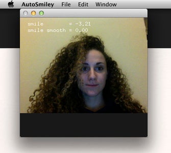

  1. Download and Install the AutoSmiley-001-Mac.zip Auto-Smiley App
  2. Once you have downloaded and installed the AutoSmiley app, open it and make sure it connects to your computer’s webcam and recognizes your smile. It should look like the two photos seen above.

      13. Next open up the Auto Smiley app. Click into the text ribbon in the serial monitor and SMILE.
      14. The Auto Smiley app should send the :) signal to your serial monitor. The serial monitor will recognize the colon (:) and will respond with ‘ABC’ as well as trigger your motor to run for 5 seconds! *(The Auto Smiley app will type :) into any application you have open that allows typing, so be careful not to accidentally smile while clicked into your code window)*
