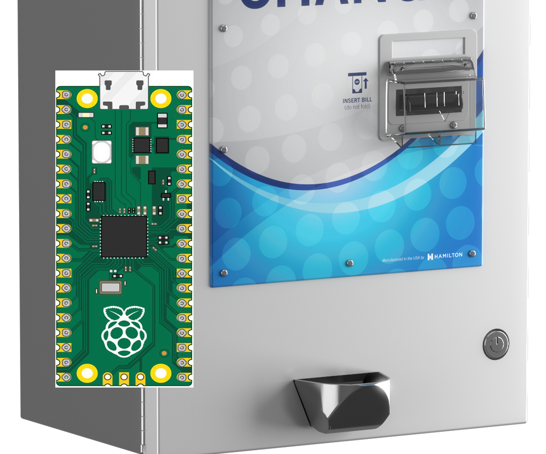

Introduction: Smoke Alarm Alerting System
We have an unattended laundromat, and people keep smoking in the bathroom. So I installed a Smoke alarm that sends Emails and text when the alarm is triggered.
