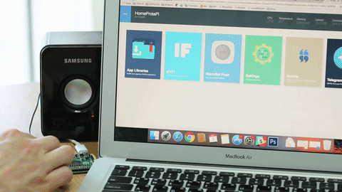

Step 3: CONNECT YOUR SPEAKERS AND YOUR MUSIC STORAGE
Do you have old speakers that you don’t use anymore? You can connect them very easily with your Prota Pi to automatically play music stored on it and give them a second life.
First, put your favorite songs on your USB stick. Next, plug your USB stick to your Prota Pi.
Set up Volumio
  • Go to App Libraries and download Volumio app
  • Open Volumio
  • Click on the bottom left button “Browse”
  • There you will be able to select the songs and radio stations you want to play. Add them to your playlist.
The shared folder contains the audio files added on your USB stick.
Volumio app will play the music added to the playlist from the USB stick.

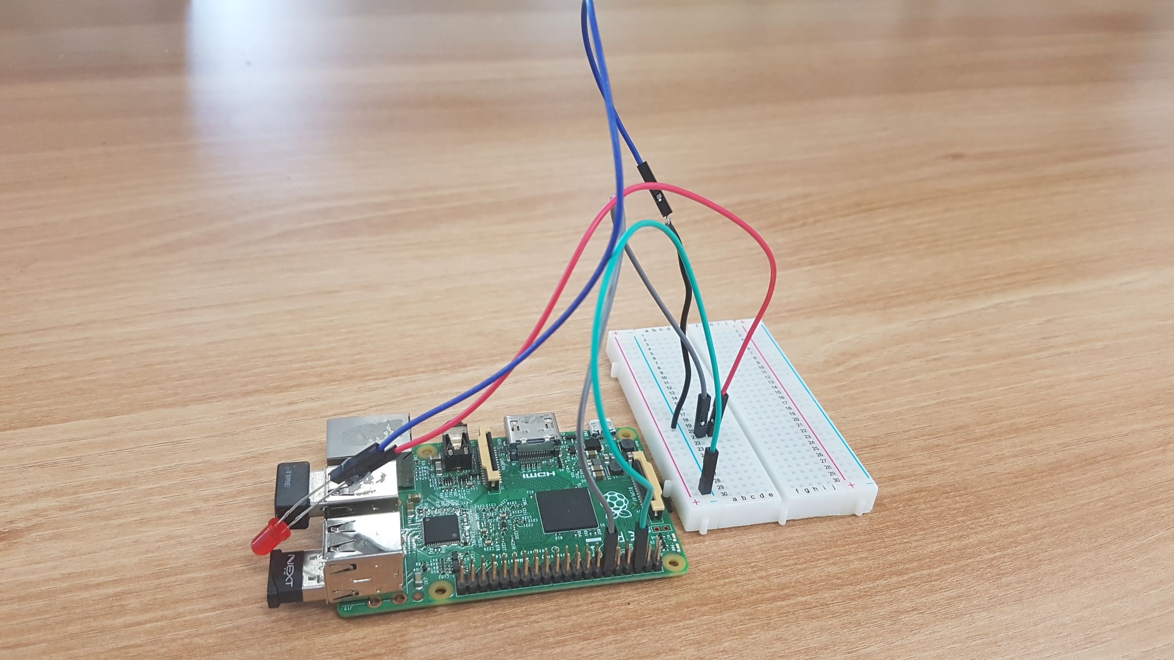

Step 6: INTEGRATE LEDs TO YOUR AMBIENCE SYSTEM

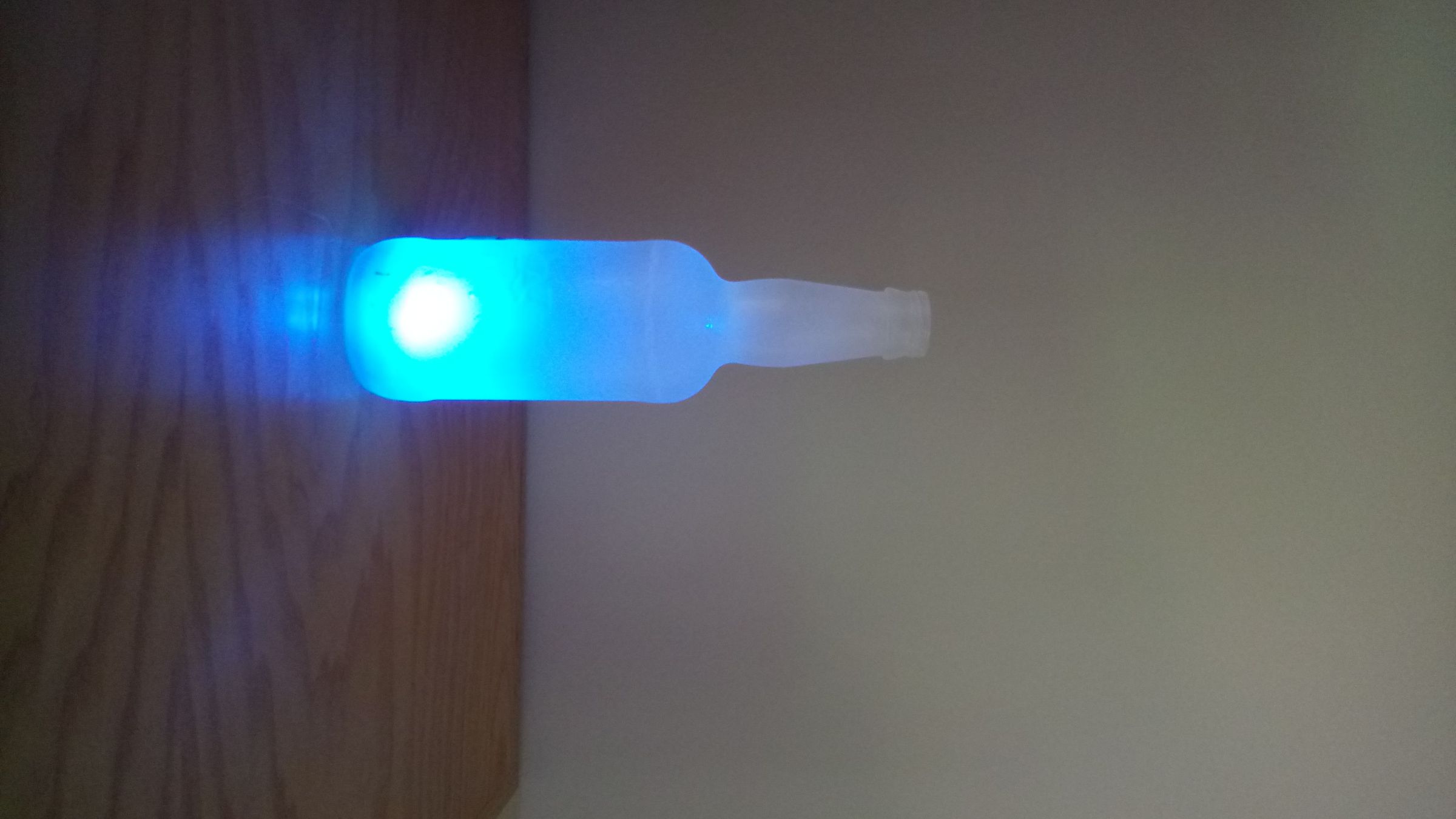

LEDs are very cheap components. You can buy a pack of 300 for around $10 ( here for instance). If you’re willing to put more money into it, you can find interesting LED cubes kits or modules (like this one and this one).
In order to make your LEDs more visible, we suggest that you insert them in used glass bottles, perforated with a glass drill and covered with a frost glass spray as explained in this great Instructables. This step 6 aims at showing you how you can reproduce the LED part of this project via Prota OS. Please refer the Color Changing bottle project for transforming used glass bottles into lamps (as seen below).
Color Changing bottle project from Chanandler Bong

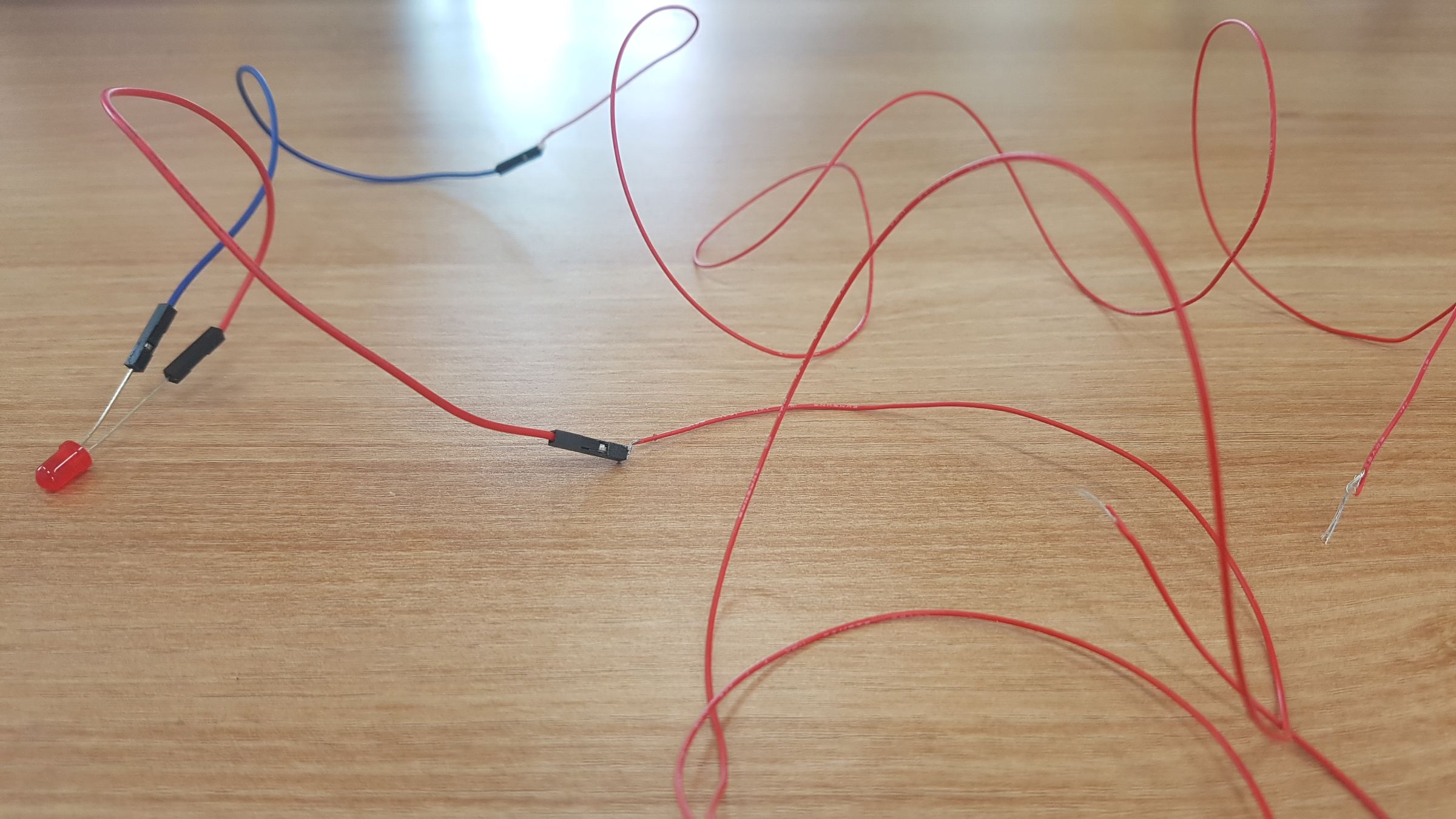

Connecting LEDs via your GPIO breadboard is very easy. A breadboard is a board that helps you connect electronic components with your micro-computer Raspberry Pi (here we want to connect the LED lights via the breadboard). By connecting your board to the GPIO pins of your Raspberry Pi, you will bring the current to turn them on.

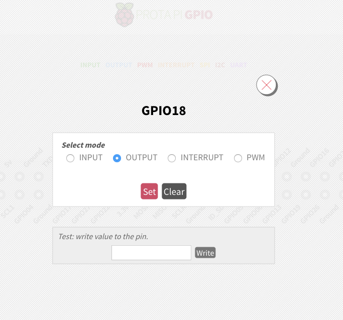

The only requirement for connecting LEDs is that one leg (the longer one) is connected to a source of electric current (we suggest GPIO18) and that the other is connected to a ground pin (GND). Using the breadboard as an intermediary between your LEDs and RPi allows you to use only one GPIO pin and one GND pin to electrify all your LEDs.
In order to connect LEDs from a long distance and cover a bigger part of your room, you can connect electric wires between the LEDs and the breadboard. This will allow you to put the LEDs into the bottles and spread the bottles in several corners. Make sure to hide the cables behind furniture or find creative ways to do so.
Once everything is connected, you can set up GPIO 18 on “output”. Test it by writing 1 or 0 in the value box. Typing 1 should bring current to your LEDs and turn them on, and they should turn off when writing 0.

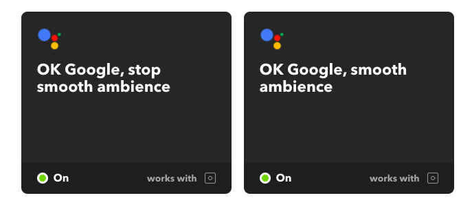

Google Voice Assistant:
Applet 1:
IF I say “OK Google, smooth ambience” THEN Prota execute the storyline 1
Applet 2:
IF I say “OK Google, stop smooth ambience” THEN Prota execute the storyline 2

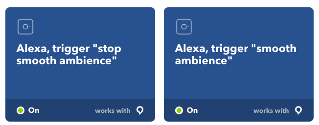

Amazon Alexa:
Applet 1:
IF I say “Alexa, trigger smooth ambience” THEN Prota execute the storyline 1
Applet 2:
IF I say “Alexa trigger stop smooth ambience” THEN Prota execute the storyline 2

The LED are not very bright on the video, but using the technique mentioned earlier of frosting your bottle should give you a nice DIY way of creating smooth lights, which of course can be replaced by any other smart light alternative you’d prefer.
