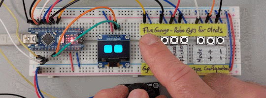

Step 1: Prepare Breadboard Layout
- Attach the Arduino, the display and the buttons to the breadboard. I'd suggest to use similar positions for each component as shown in the image.
- Connect the Arduino's 5V out to the breadboard's plus-line and the Arduino's GND to the breadboard's minus line.
- It's helpful to also wire the just connected plus and minus lines with the respective plus and minus lines on the opposite side of the breadboard.
- Connect the display's...
- ... GND to the breadboard's minus line
- ... VCC to the breadboard'S plus line
- ... SCL/SCK to the controller's I2C serial clock pin (=A5 on Arduino Uno or Nano R3)
- ... SDA to the controller's I2C serial data pin (=A4 on Arduino Uno or Nano R3)
- Connect each pushbutton's upper right leg to the breadboard's minus line (see picture for reference), then connect each pushbutton's upper left leg to the following Arduino pin (no resistors needed, we'll use the Arduino's internal pullup resistors):
- Mood button to D5
- Laugh button to D6
- Confused button to D7
- Flicker button to D8
- Mode button to D9
- Mode + button to D10
- Mode - button to D11
- For the joystick, connect everything as follows:
- Joystick's GND to breadboard's minus line
- Joystick's +5V to the breadboard's plus line
- Joystick's VRX to Arduino pin A0
- Joystick's VRY to Arduino pin A1
- Joystick's pushbutton (SW) to Arduino pin D12
Step 2: Upload Sketch
Once the hardware is ready to go, connect your arduino to your computer. In the Arduino IDE, go to "file > examples > FluxGarage RoboEyes for OLED Displays" and open the "ConfigurationBoard" example.
Then upload this sketch to your Arduino.
Step 3: Play Around
Now it's time to play around with the board and to create your custom eye shapes, if you want to. Initially, the eyes start with the "autoblinker" and the "idle mode" turned on, meaning the eyes will blink and reposition automatically.
Using the Joystick and its Button
By pushing the joystick's button, you can turn the idle mode off, meaning you can then freely position the eyes with the joystick. Pushing the joystick's button again, reactivates the idle mode.
Mood Button
By pushing the mood button, you can switch between the different mood types. Currently, "tired, angry, happy and default" are available.
Trigger Animations
Pressing "laugh, confused or flicker" triggers the respective animations, while laugh and confused are oneshot animations and flicker is an infinite loop animation that will be "played" as long as you hold the button (the library allows to set the flicker on or off, as well as setting a pixel value for the amplitude).
Eyes Configuration Buttons
The "mode" button allows you to switch between the eye manipulation modes listed below. Use the plus or minus button to increase or decrease the values inside of each "mode". Behind each mode title that will be displayed shortly, there is the current value of the width, height, border radius and the space between. This can be helpful if you want to write down the values for later use, since the configuration won't be saved when unpowering your arduino.
Modes:
- Width
- Height
- Border radius
- Space between
- Cyclops toggle
- Curiosity toggle
- Predefined positions
