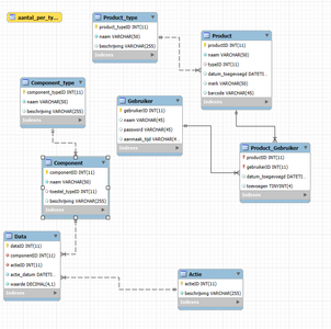

Step 2: Database
Second, I created the database to store the data from my sensors and the products scanned by the barcode reader.
(The schema for creating the database will be provided in the GitHub repository under the 'data' directory.)

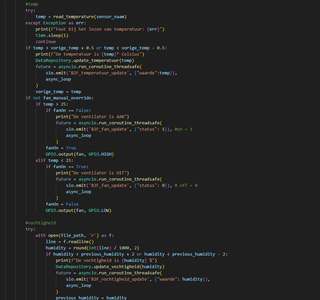

Step 3: Code
This was the most time-intensive phase. First, I wrote Python code to read the sensor data. I created test files for every sensor and ran the code to verify functionality. Then, I added an LCD display using a custom class I designed to simplify integration.

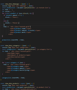

Next, I implemented SQL in the data repository for FastAPI calls, creating functions for all anticipated requirements. Third, I designed the HTML and CSS, starting with Figma sketches to visualize the layout. Finally, I wrote JavaScript to display data on the website. After initial implementation, I made adjustments to ensure everything worked correctly.
Once the core functionality was operational, I redesigned the website to my preferences—feel free to modify it to suit your tastes.
(The full code is available in the GitHub repository under the 'front' and 'backend' directories. Most parts of the code include comments for further details if needed.)
