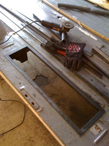

In an Econoline there are 2 natural spots to add a box. The one I am using here is just inside the side doors behind the rocker panel. The box I built is 32 in long x 11 in deep x 8 inches wide. I used these dimensions to make it possible to hold up to 2 batteries. Your dimensions may vary or need adjustment as you progress depending on your needs and also how accurately you are able to cut the hole into the floor.
To cut the hole I identified natural lines that will not intersect with the frame or other important structures underneath the van and also worked with the ridges that are embossed into the sheetmetal floor of the van. I cut the floor with a portable Plasma cutter which goes through metal like warm butter but you could also use a high speed cutting wheel.
Measure out the hole you will cut and draw a line to follow with chalk or grease pencil. It is a good idea to drain and remove your gas tank before you do this step.

Once you've cut the hole it's time to grind down any rough spots and even out the lines so they are nice and straight. The edge doesn't need to be perfect because it will be covered by the angle iron but it should be fairly straigh so the lip of metal gives something to hold on to. Remeasure the hole to confirm the final size. Cut your 1/8 x 1 inch angle iron to fit the length of the hole plus 1 extra inch on either end. you will notch a square out of the underside of the angle iron so it will have a lip extending out onto the floor. This will mate with the connecting bars that fit between. Line up the 4 angle iron parts and confirm that they are the correct lengths and that they mate well inside the hole that you cut. The function of this part is to grip the edges of the hole and be the main support of the contents of the box.
