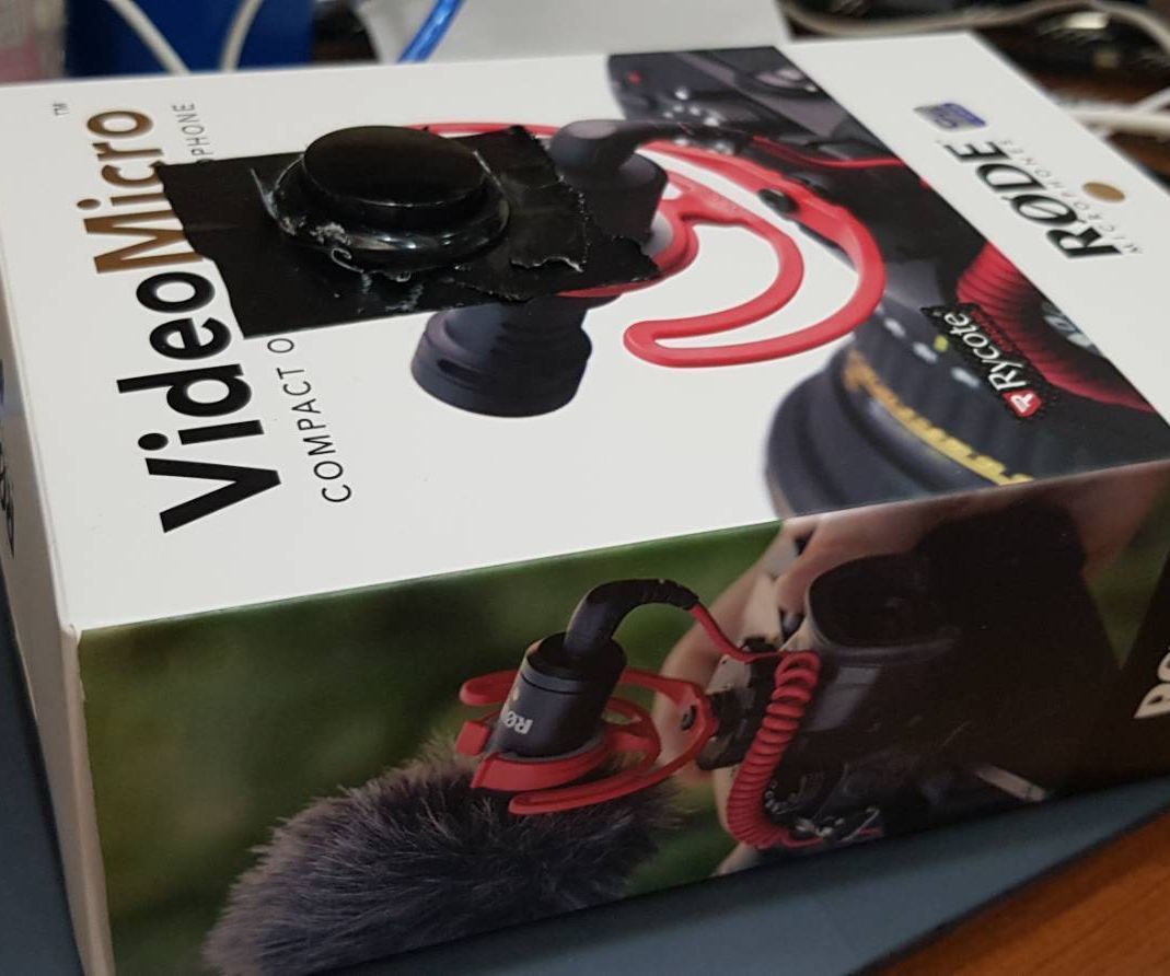

Arduino Leonardo
MAX7219 8*8 - if you bought the wrong one, you can cut it yourself.
Box - any box
Joystick
Jumper wires
Breadboard
Battery carrier
Battery case
Batteries
Step 4: Code
https://create.arduino.cc/editor/rocky_chen/75591c57-dad5-45ab-bf36-ceab4009d299/preview
Step 5: Hardware Setup
First of all, connect the Arduino 5V to the + on the Breadboard, and the Gnd to the -
LED matrix:
Now you take your LED matrix and connect the VCC-pin to the volt-line and the GND-pin to the ground-line. After this you can connect the DIN-, CS- and CLK-pin accordingly to the 13-, 12- and 11-pin on your arduino. Your LED matrix is operational now
Joystick
Connect the VRx- and VRy-pin to analog pins 0 and 1 on your arduino (A0 and A1) and connect the SW-pin to the 2-pin.
Battery
7-12V recommended, for example a 9V battery with a 9V battery snap connector.
