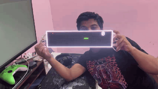

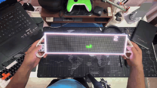

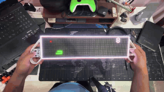

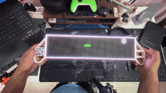

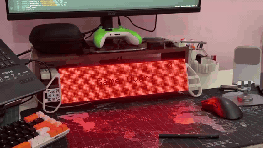

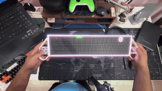

Hey everyone! Presenting the Snake Game Console MAX
The updated Snake Game Console incorporates two RGB 64x32 P3 matrix panels into a single ultrawide 128x32 display. It uses the same PICO 2 display driver as the previous project, but I designed a new 3D-printed frame to accommodate both displays adequately, complete with integrated handgrips and a D-pad buttons PCB for snake control.
We developed the original Snake game by reusing and tweaking code from the previous Snake Game project. The game's focus stays on a simple snake object, which you control with four directional buttons to aim for randomly appearing red dots around the LED grid. Every time the snake eats a dot, it grows longer, and your score (shown in the upper-right corner) increases accordingly.

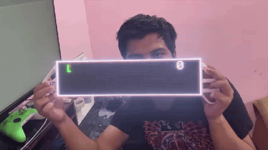

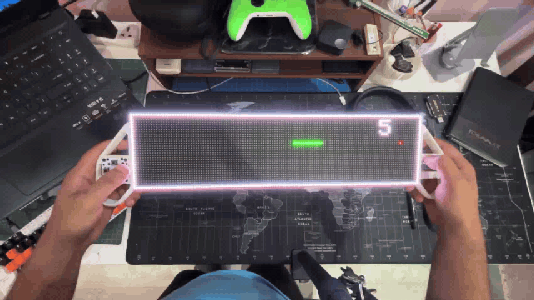

This version includes a visible border around the entire display. If the snake hits the wall, the game stops immediately, adding an additional level of difficulty to the game experience.
We've also added a Speed Up option that allows the snake to move quicker when any button is held down for a second in the direction it's moving.
The console is powered by an inbuilt 3.7V 2600mAh lithium-ion battery, making it completely portable and easy to pick up and play anywhere.

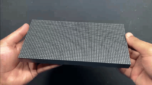

For this project, we are combining two 64x32 P3 RGB Matrix panels to create a larger 128x32 P3 RGB Matrix Panel.
You can click the link below to read my brief introduction to this matrix panel.
https://www.instructables.com/64x32-Matrix-Panel-Setup-With-PICO-2/
This panel is powered by the HUB75 interface, which uses a variety of control pins such as RGB, address, clock, data latch, and output enable pins.
The row-column scanning approach is enabled via the HUB75 connection, which shifts a row of pixel data into a shift register. A demultiplexer is then used to select which rows to display. The HUB75 connection features RGB channels, addressing pins A, B, C, and D, a clock signal (CLK), a latch signal (LAT), and an output enable (OE) pin.
We can also connect additional panels in pairs to form a chain using the IN and OUT connections provided.
One of the challenges of connecting numerous panels is ensuring that the control solution (PICO 2) can handle the increased data load of two or more displays.

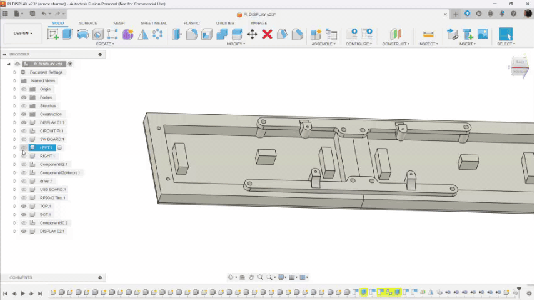

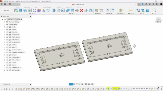

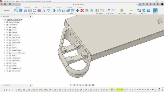

Step 2: Updated Console Design

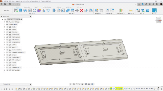

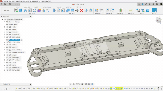

The first step in developing the Snake Game Console MAX was to create an updated 3D model of the housing to suit the improved dual-display setup. The new version combines two 64×32 P3 RGB LED matrix panels into a seamless 128×32 display, resulting in an even wider playfield.
We reused the original switch board and PICO driver circuit, securely putting them below the matrix. To structurally unite the two panels, we created and incorporated two customized Frame Holder components that link panels and keep them aligned.
The left and right handgrips were also rebuilt, not just to handle the larger chassis, but also to improve comfort. The revised grips are more ergonomic, making lengthy gameplay sessions more enjoyable.
As before, the handgrips are fastened to the matrix's back via M2.5 bolts and built-in M2.5 inserts. Four M2 screws hold the side button board in place.
After 3D model was completed, the mesh files for both grips and the new frame holders were exported and 3D printed in white PLA on our new Creality K10 Max with Hyper PLA @ 0.2mm layer height, 0.4mm nozzle, and 600 mm/s acceleration speed.

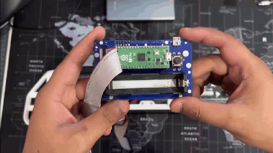

Let's have a look at the hardware used for this project. We used the PICO Driver and Switch boards from the previous Snake game console build.
The PICO Driver board connects a Raspberry Pi PICO 2 to a HUB75 connector. The matrix's HUB75 pins (CON 16) are linked to the PICO's GPIO pins in the following order: A to GPIO19, B to GPIO16, C to GPIO18, D to GPIO20, E to GPIO22, CLK to GPIO11, LAT/STB to GPIO12, OE to GPIO13, R1 to GPIO2, G1 to GPIO3, B1 to GPIO4, R2 to GPIO5, G2 to GPIO8, and B2 to GPIO9.
We included a CON5 connector for buttons, with four pins connected to PICO's GPIO6, GPIO7, GPIO14, and GPIO15. GND is connected to CON5's fifth pin. Each GPIO will be pulled to GND by the button board that connects to this CON5, which PICO will recognize as a button press.
We also used a power management IC, the IP5306, a fully integrated multi-function power management SoC, to power the complete system.
It can provide a steady 5V 2.1A using 3.7V as an input, which can be used to power any 5V device—in our instance, the matrix and PICO 2.
You can check out the IP5306 Datasheet for more info: http://www.injoinic.com/wwwroot/uploads/files/20200221/0405f23c247a34d3990ae100c8b20a27.pdf

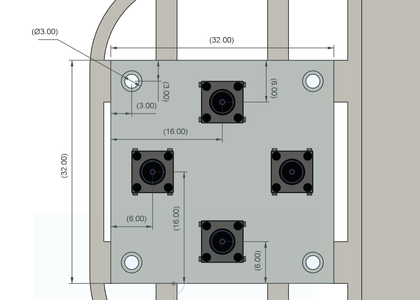

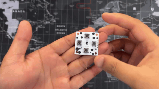

The Switch Board contains four push buttons that are coupled to a CON5 terminal, which will be used to connect the Switch Board to the PICO 2 GPIO Pins.

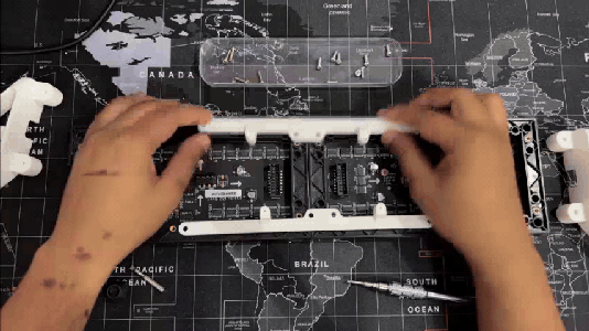

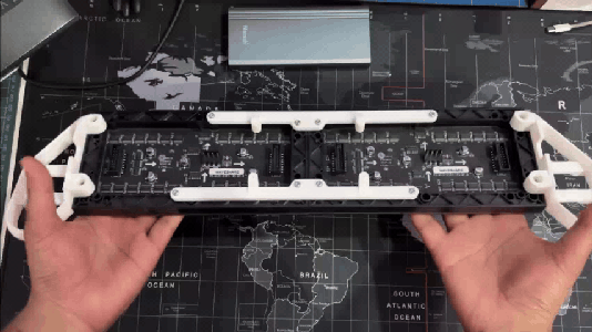

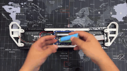

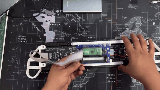

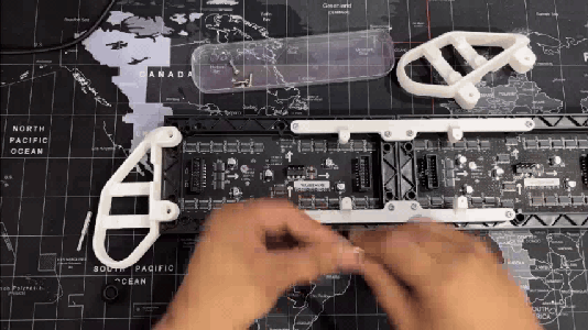

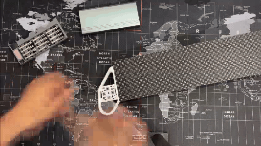

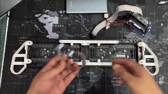

Step 5: Frame Assembly

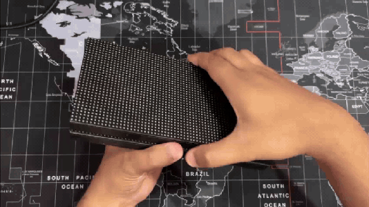

  1. We began the assembly process by connecting the two matrix panels together using the display frames placed over the M2.5 inserts of the two matrix panels.
  2. We then used four M2.5 bolts to secure each display frame to the back side of the matrix panel.
  3. Next, on both sides of the matrix panel, we have attached the handgrip, which is placed over M.25 inserts, allowing us to attach bolts to tighten the handgrip part to the matrix.

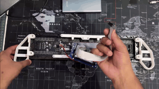

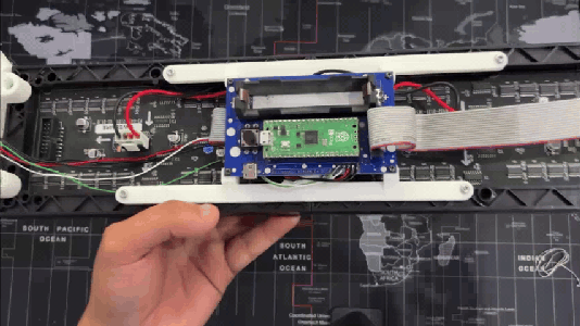

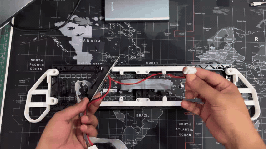

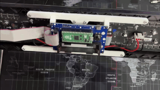

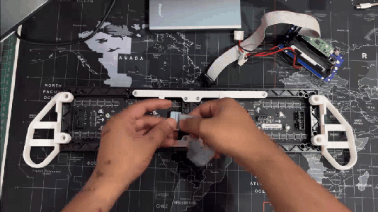

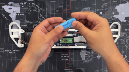

Step 6: PICO Driver Assembly
  1. Next follows the PICO Driver Assembly, which begins by connecting the two matrix panels in a chain by attaching the included HUB75 Ribbon Cable connector to Dout of the first matrix and the other end to the Din of the second matrix panel. This is comparable to the way RGB LED WS2812 LEDs are connected.
  2. We are employing 2 RGB matrix panels, which means we need to provide power to both panels. To do so, we connected two power connectors in parallel with our PICO Driver's 5V and GND. Then connect both female power connectors to both matrix male power connectors.
  3. Next, the HUB 75 connector of the PICO Driver is linked with the Din of the first matrix.
  4. After all of the connectors are plugged in, we align the PICO Driver with the screw bosses added to the Display Frame and secure it with four M2 self-tapping screws.

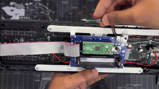

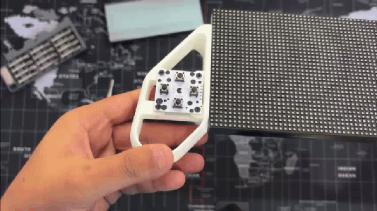

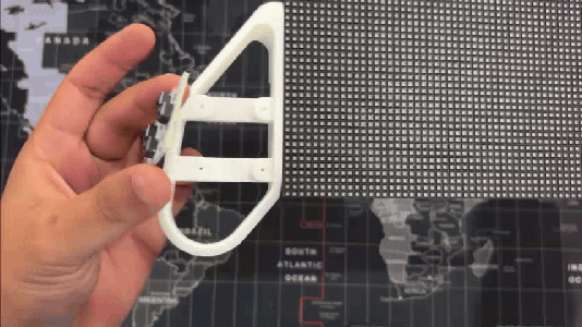

Step 7: Switch Board Assembly
We install the Switch Board over the four screw bosses on the Left Hand Grip and then use four M2 screws to secure it to the Left Grip part.

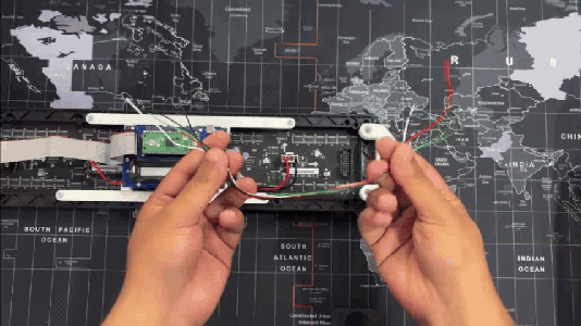

Step 8: WIRING

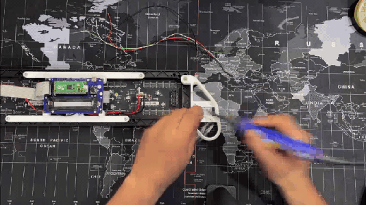

Now follows the wiring step, which requires five long connecting wires to link the Switch Board to the I/O of the PICO Driver Board.
  1. We begin by using a soldering iron to connect wires to the Switch Board's UP, DOWN, LEFT, RIGHT, and GND connections.
  2. Following the wiring order, the Connecting wires attached to the Switch Board's Terminals are all linked to their respective GPIO Pins on the PICO Driver board. We're using the provided Wiring Diagram to connect the switch board and pico driver together.

Step 10: RESULT & CONCLUSION
The project resulted in an even longer Snake Game Console, transforming a nostalgic classic into a wide-screen, portable gaming experience. This version's dual 64×32 RGB P3 matrix panels, flawlessly combined into a 128×32 display, provide a more immersive gaming experience and better visual feedback.
The addition of a border brings the classic arcade challenge to life—hit the wall, and the game is over. Dynamic speed control increases intensity by allowing gamers to accelerate with a single button press. The sleek housing, replete with ergonomic handles and a snappy D-pad, makes it not only useful but also enjoyable to hold and use.
Overall, this is a polished and portable development of my original Snake Game Console, combining code enhancements, hardware reusability, and intelligent 3D design to create a unified and extremely entertaining package.
