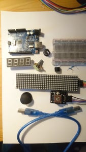

Things you need:
- Arduino Uno + Power cable
- Breadboard
- 8*32 led matrix (MAX7219 Dot Matrix Module, 4 In One Display with 5P Line)
- 4Bit led (SM420561k-32)
- 10kΩ potentiometer
- 2 x 220Ω Resistor
- Joystick module (KY-023 XY-axis joystick module)
- Green led
- Blue led
- A bunch of jumper wires
-Download the snake.ino sketch
To make the box, and the fix the parts (you can do the project without these, simply fixing everything on a single panel)
- 4x 15cm *12.5cm wooden panel
- 2x 12.5cm * 12.5cm wooden panel
- Hot glue
- Drill
- Jigsaw
Libraries you need to be installed:
MD_MAX72XX
MD_KeySwitch
Important: You might need to edit the MAX72xx.h file to set the type of matrix you are using.
