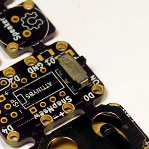

Step 4: Switch, Microcontroller, Capacitor
On the next section goes the switch, microcontroller, and capacitor:
- Solder the switch on the right hand side facing outward.
Make sure it goes in the correct 6-pin header. One header is for programming, marked "ISP", and the other is for the switch.
- Place the Attiny being sure the dot for Pin 1 is toward the ISP header.
- Solder two pins in place.
- Check the alignment and seating.
- Solder the remainder of the pins.
- Install the 0.1uF capacitor in place. It can go in either direction.

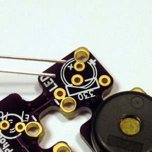

Step 6: LED
The long lead of an LED goes through the hole marked "+". Most LEDs have a flat side as well, which denotes the negative side. I like having a 3V coin cell handy to test it because I can never remember this.
I usually use a current limiting resistor, even thought the current and voltage supplied by the lithium battery doesn't require it. This will help extend battery life and will also keep the LED safe if you hook a programmer to the ISP (which supplies 5 volts).
If you are using a blue or white LED, you might use a lower resistor value like 180 Ohm, or forgo it completely. Just solder a jumper in place of the resistor.
