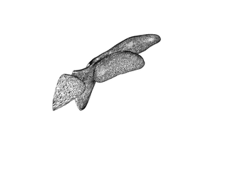

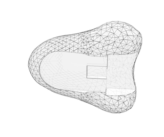

The head is printed in two mirrored halves,

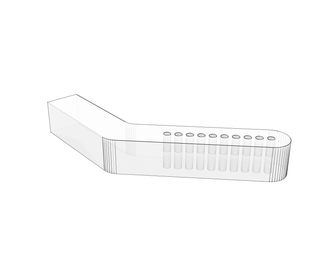

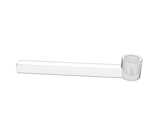

The jaw is comprised of two pieces, one to hold the touch sensor, and one to attach to the servo,
The servo is attached to the head with a piece, the dowel supports the head with a piece, and the dowel is held in place on the base with another piece.

4) Screw the arm of the jaw into the horn of the servo and insert the servo into its holder with the screw that came with the servo
