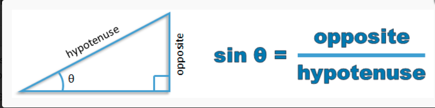

To use the sine function, you need your reference angle, the side opposite of your reference angle, and the hypotenuse of the right triangle.
Sin θ = opposite / hypotenuse

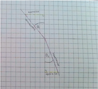

In the picture, we can see how there are right triangles in the graph. To find the value of θ1, we use the opposite side (the side that the angle opens up to) and divide it by the hypotenuse of the right triangle. Using the other triangle, we can do the same to find θ2.

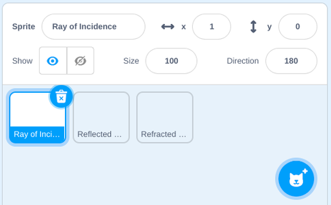

Then, we created the sprites. These can and should be the things that are changed by the code. We created a ray of incidence, a reflected ray, and a refracted ray.

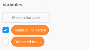

After that, we created the variables. Variables are useful because their values can be changed. We created an Angle of Incidence variable. We clicked the checkmark to make it appear on our simulation. Then, we changed it to a slider to allow the user to change the value of the angle. The second variable we made is called the refracted index. This variable is the same as n2 in Snell's Law. It will help the code find the angle of refraction.

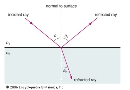

The incident ray is the ray of light that travels from the light source, whether that be the sun, laser, etc. The angle of incidence is where the incident ray first hits the water; this angle is called theta 1 (Θ). We set limits for the variable as its values could only be 1-90. The dotted line that continues into the 4th quadrant represents the path the light would have travelled if the medium didn't change.
When light rays hit the surface of an object, often some of the light is reflected off the object. The code for the line of reflection is almost the same as the code for the incident ray. The only difference is that the line is reflected across the y-axis.
The refracted ray was the most difficult to code. We used Snell's Law (solved for Θ2) to help the simulation determine which direction the ray should point.
